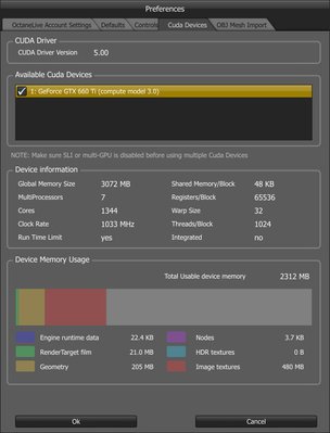

hey fooze, thnx for the response!
so i tried it again tonight and more memory freed up. last night it went up to 650 mbs and just stopped there and from above that octane crashed a few times. Now it seems to be using the full extent of it, sitting at 700 mbs being used at the moment with more 4k textures loaded in...
this is the CUDA info however, maybe you could figure something out from this and tell me a little bit about how I'm managing this because not all of these make sense to me. Some tips to increase the speed of my render would be nice!

The things you want to take note of are:dkreset wrote:hey fooze, thnx for the response!
Total usable device memory - this is showing 2312MB which means that about 600MB is being used by something else (3d application or windows if you have your monitor plugged into this card).
Geometry - this is all the obj files
Image Textures and HDR textures - these are all the textures in the scene
Render Target Film - this is the place the final render is stored and increases when you increase the render resolution.
The speed of rendering is more related to kernel type, settings and scene optimization (light placement, using IES lights etc). How much VRAM is used has no direct impact on performance (other than your scene being more complex and therefore taking longer to render).
