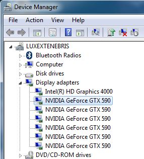

Trying to put together a GTX 590 quad setup. I have 2 classified and one Asus gtx 590 (so far, the other is coming) I see the GPU Clock on the Asus is 608 vs the Classified which is 613. I am wondering if there is a driver issue by running mixed 590 cards as I had it showing 6 cards in the device manager but windows updated the driver and now I only show 3 cards. Octane is only showing 3 cards as well. I have the Nvidia multi GPU disabled. Is there a problem running different 590 cards?

What do you mean by "windows updated the driver"? Did windows automatic updates do this?
I would make sure you have a clean install of 310.90 (download from nvidia and then go advanced/custom during install and there is a tick box for clean install).
Also once your system is confused like this, i find it's best to cut back to one card, install the drivers with clean install, make sure the one card is working then start adding more. Wait for windows to recognize and install the software for the additional card, once that's done. Restart, then check it's working, rinse and repeat for the 3rd card. I have had problems when installing too many cards and making too many hardware changes too often, i think windows and the drivers get tied up in knots somehow and stripping back and clean installing seems to work ok.
I wouldn't think different makes or clock speeds should be a problem...

Thanks again Chris,FooZe wrote:Hi Buzby,
Chris.
Yes Windows updated the driver so after I posted this I did a clean install of 310.90 and you are correct it now shows 6 cards again. and I am pulling 19.21

Update- I set up using 3,5, and 7 last night using 3 as the display and just plugged in my 4th 590 into slot one and I now was able to boot with full display.
Caveat is windows only shows 3 not 4 cards in the device manager! Likewise Octane does not see the fourth card. Now what?

Try reinstalling the NVIDIA driver (310.90). Sometimes that helps.buzby wrote:Update- I set up using 3,5, and 7 last night using 3 as the display and just plugged in my 4th 590 into slot one and I now was able to boot with full display.
