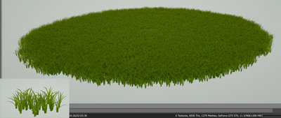

You can make grass made out of replicator, but not out of hair.
create material> add surface generator layer to it>
> create replicator of a grass mesh with paint source of surface generator > freeze and select instances, then run script and save for octane use
You may change mesh to low density one before making it freeze , sow it cause no troubles to modo viewport.

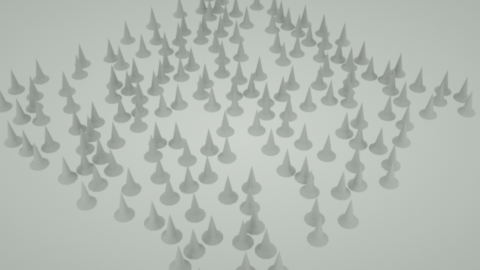

Loaded on fist post. Strange, i thought archives not allowed to attach.funk wrote:I'd love to try this but the link says:

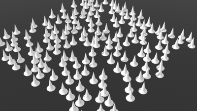

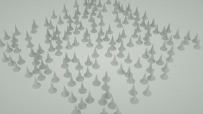

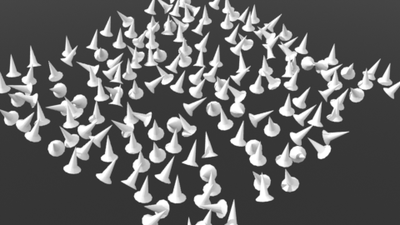

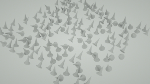

Actually it doesnt seem to export rotations correctly (position and scale work fine). If you compare the 2 attached images, all the positions are correct, but the rotations are not

yes i think it don't work properly on angles more than 90degrees, need to correct formulafunk wrote:Actually it doesnt seem to export rotations correctly. If you compare the 2 attached images, all the positions are correct, but the rotations are not
I tried selecting items in different orders and using different action centers but the octane render was always the same.
Anyway, I'm not sure this really matters too much.
