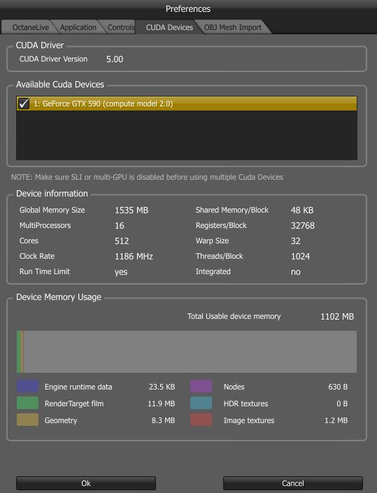

Just a quick question which seems fairly obvious, but want to make sure I am not missing something. I purchased a used GTX 590 and am showing only 512 cuda cores. See pic. Is one side of this dual card burned out? It should be showing 1024 correct?

You should be seeing two 590 items (one for each GPU).
Have you made sure to disable multi-GPU/SLI in the nvidia settings?
What is the windows device manager showing you?

Yes Device manager only shows 1 590.
Nvidia control does not give me SLI at this time as I only installed one card.
Looks like I have a bum steer, too bad, I am assembling a quad 590 setup in my CoolerMaster Storm Trooper and this is the first card that arrived. Hoping to create a similar benchmark score to your quad 690 (actually trying to beat it :p ) Looks like I will have to wait another day...
