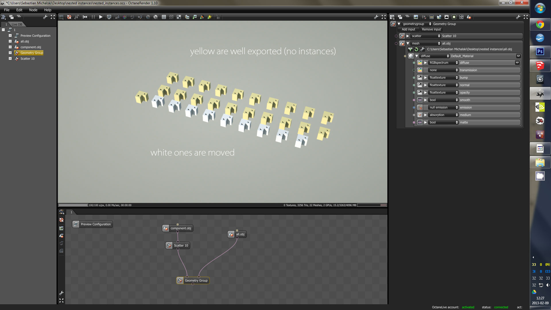

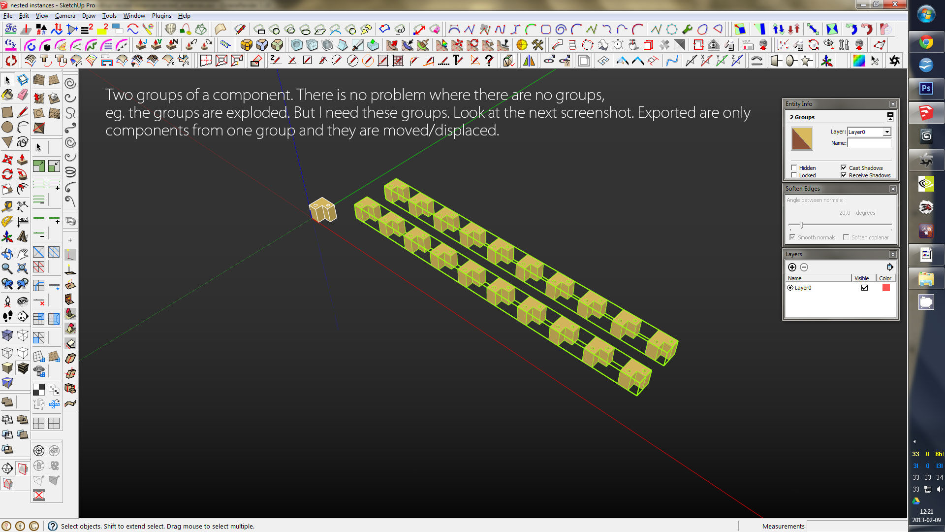

When I use the plugin for exporting components data into scatter data I encounter a problem when components are grouped. Namely, I have a component copied 10 times. Then a group is created. The groups is copied twice. A single copy of a component is created at the project origin. I run the plugin. The data that are exported are for 10 components only (from the first group) and they are all displaced (because - I suspect - the exported obj is at 0,0,0).
So my question to you is - is it possible to export the data for components that are in all groups without a need to explode them. This is so important to me. If this problem is solvable we can create nested components and use connected consecutive scatter nodes for multiplying instances.

If I make a components of sub-parts it is still displaced by the distance from origin. The problem of setting the component exes to origin goes back.

Now I am experimenting with nested components, and still have a problem with additional displacement when I export (scatter data) a component inside a group or a inside another component. If you find some time to play with the file I previously uploaded I could come up with a solution to the problem I'd be grateful.
