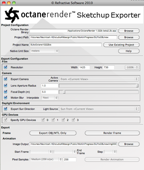

Hey TIG,
the plugin UI seems fine now but the "default" thingie it's always the same (I made a brand new test file and never saved it after testing the Octane plugin). are those info stored into some .pls/config file so we have to delete it before staring a new session of tests?
cheers,
A

:) We're getting somewhere !
At least the dialog is working now without scrollbars etc !!
The dialog's defaults are set by a 'populate' command.
There are the defaults [most off, but camera on] set for any new SKP.
The settings [with any changes] are remembered in the SKP file's database [only the binary-path is kept in the Window's Registry or MAC's Plist...]
On a PC the current SKP's settings are 'populated' without problem.
The way that some versions of Windows and certain browser versions etc interacted with the dialog's sliders gave a rare PC js error message that was annoying as it stopped you, warned you and when you continued everything worked OK anyway! Tweaking when the 'populate' ran fixed this for the PC and it ten ran perfectly in all PC versions...
Unfortunately the PC adjustments broke how the Mac version worked. I separated the dialog's html code files for PC and MAC so I can have different coding for each and hopefully get the MAC version working as good as the PC's.
Clearly the current version still fails to set the 'defaults' or values properly on the MAC :roll: I'll post another html version shortly - hopefully this might work for you...
Thanks for you feedback and support - I will get this sorted for you MAC users...

SurfingAlien
Posts: 355
Joined: Thu Jan 21, 2010 12:05 am
TIG
I confirm what Marty said: blank page again with the latest .html
I tried with the old one (aa): create new file, saved, open Octane plugin unchecked some defaults and tweaked some sliders, closed Octane plugin, saved file, closed SU. re-open SU, re-loaded file, called Octane plugin -> all values/sliders/checkboxes reset to default (so it doesn't seem to remember tuned values on save)
I'm afraid you'll have to borrow a Mac from some friend of yours to get the thing sorted easily... :roll:
