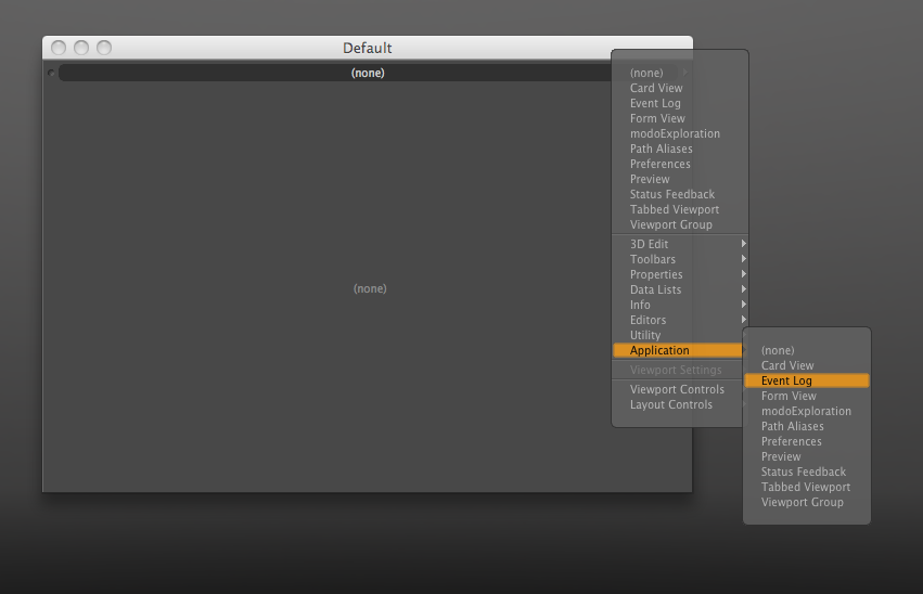

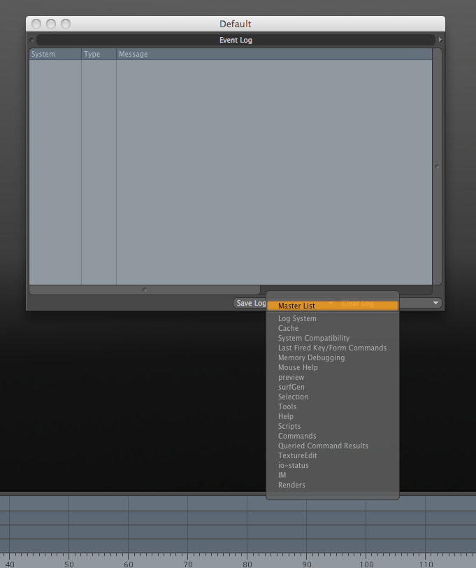

ps. attached screen shoots showing how to get to the event log.
