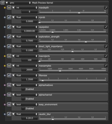

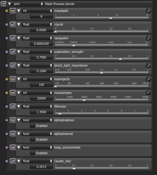

its hard to answer your question without any images or further detail, but I only use PMC for all my renderings, which recently includes 2 minutes of full HD interior animation.
PMC is the only viable kernel to use to avoid flickering with various assortments of architectural settings, hence why I have so many graphics cards. PT and DL often fail to clean up all the speckles in a time shorter than PMC and using the firefly removal slider is a complete FAIL in my opinion - it just adds a nasty blur.
try using PMC with max rejects set to 100, and caustic blur at 0.2, then pick an acceptable sample level IE 4000-8000 depending on how much time you have to render the project out.
