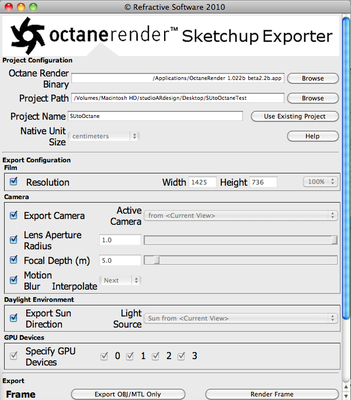

I can't see any difference between Y and Z... it works but the UI issues are still there:
I also noticed that the render use a texture environment (float) even if the "export sun position" is checked by default in the exporter; if I uncheck it and check it again the render starts correctly with daylight
We can live with that anyway, TIG... we got our plugin and it works quite well already. I can imagine how hard is doing these fine tuning without having a Mac to test it directly.

I am disappointed that the MAC version is still so flaky :cry:
I'd like some feedback from PC users that at least their version is working fine [it should be] :?:
I've now split the PC/MAC versions of the html code for the dialog, so it might make the debugging of the MAC side easier.
The MAC is clearly failing to 'populate' the dialog properly...
I'll prepare an alternative html and issue just that so MAC users - as an alternative to the one included with this beta [Z]...
Then if you [SurfingAlien/Burkhard et al] can try swapping them arouns we might get nearer to a solution...
Incidentally does the file-browser dialog work acceptably on the MAC now ?

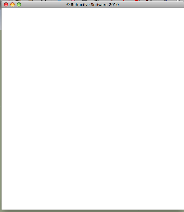

This is for MAC testers only...
Just a thought... MAC users... IF you have saved the SKP after the 'Octane Render' dialog incorrectly checked various settings then these will get remembered with the SKP if you have saved it. Therefore even if the thing is populating properly things will appear checked - you need to test with a new SKP that has no settings saved in it to get a true picture of what's happening...***
Here's a zipped version of a new MAC html file, revised to see if the main dialog's 'populate' can be sorted.
OctaneDialogMAChtml.zip
(2.77 KiB) Downloaded 309 times
Can MAC testers please extract it and put it into their ../Plugins/Octane/ folder in place of the original file.
Then restart SUp*** with and try the 'Octane Render' tool again - and report if/how it's working.
The dialog shouldn't have scrollbars - the font that the MAC is using for the 'titles' seems to be too big and thereby causes the info to 'overflow'. I have adjusted the css part of the html to try and help with this too...
MAC users - feedback please...

ehm... :?: :!:

That didn't work then ! :roll:
I'll come up with something for tomorrow !
