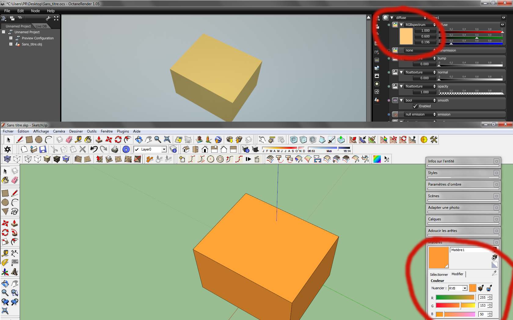

I have trouble with RGB colors, they do not correspond with sketchup,
see attached example. please help me. I use sketchup 8 and octane1-05
thanks.

The two colors do correspond 'exactly'.
SKP uses RGB 0 .. 255
OCS uses RGB 0 .. 1.000
The exporter translates the SKP integer values into the OCS float format to 6dp.
In your example the R & G [V] are exact, and the B is to within 0.0000..., but 'exact' to the accuracy of 3dp for the input/display allowed in the OCS anyway.
R: 255/255.0==1.000
G: 153/255.0==0.600
B: 50/255.0==0.196[078431372549020]
Your display drivers 'gamma' settings might need correcting at each app's level ?
This might explain how the same color appears differently in the two windows, when the numerical values are actually the same, just shown in different formats...
Also a rendering 'material' might use other properties unavailable in the SKP, and 'ambient' lighting affects etc changing how a color 'looks'...
Try adjusting some of those other settings to see if the OCS 'orange' approaches that of the SKP ???

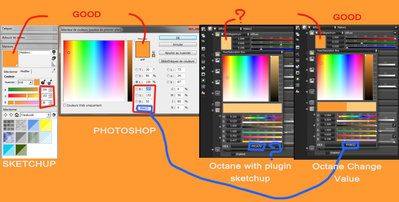

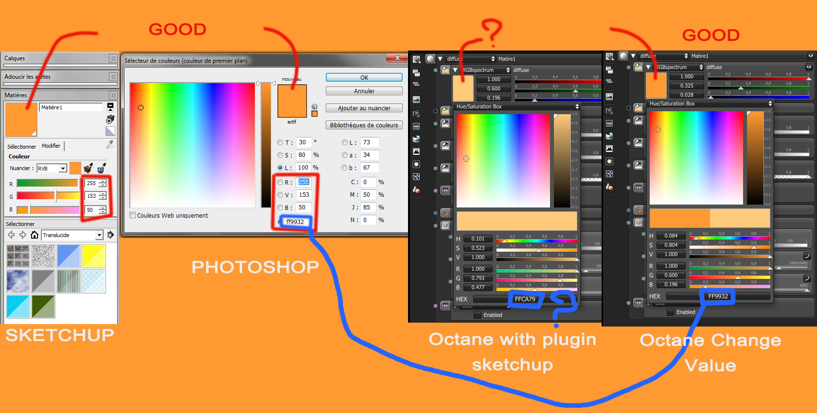

Excuse me, but for me it is not good I did a comparison of colors with Photoshop, see attached example. if you change the values ​​"HEX" as the photoshop colors is good!
thanks

BUT then by transferring the hex value you have set the G[V] to 0.325 which is not 153/255 [0.600] AND B to 0.028 which is NOT 50/255 [0.196[078431372549020]
Seems to me that Octane's colors as % RGB 0.000 .. 1.000 as opposed to the SKP's 0 .. 255 don't work right...
Raise this issue in their general forum as it's not directly Sketchup related, because surely you agree that a B of 153 in the SKP system is 60% of 255 NOY 35% and for G of 50 in the SKP system it is 19.6% of 255 NOT 2.8% ?
An OBJ's MTL passes color as % [0.000000... 1.000000] so the OCS needs to interpret those... Octance seems to be wrong in it's relationship of RGB % to hex! NOT the exporter...
