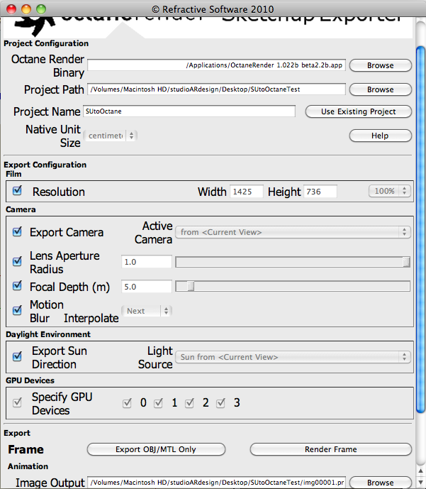

Attached a default export without *any* changes in octane from the current free sketchup Mac OS X version and a house model.
The last thing that remains, which i already said,
is that you need to disable the checkboxes for resolution, lens aperture radius, focal Depth (m), motion blur, sun direction, GPU devices.
EDIT: Just noticed this is indeed already done in the windows version, but not in the mac version, in the mac version all tickboxes are enabled/tickled by default.
About the GPU device selection, why are the checkboxes they greyed out / inactive ?

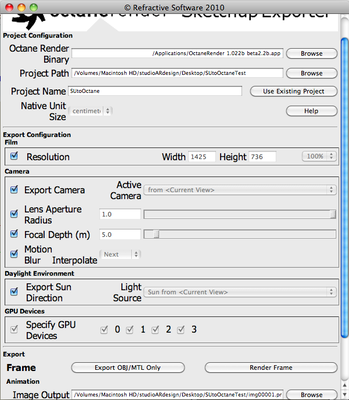

this is working fine so far (no animation tested), but there's something different in the plugin UI (see screenshot: bigger fonts, some button glitches when pushed -non visible- etc.) at least on the Mac side
still some option is not accessible (greyed out or "unchangeable") like film resolution, vCards, etc. but I guess this has to be implemented yet?

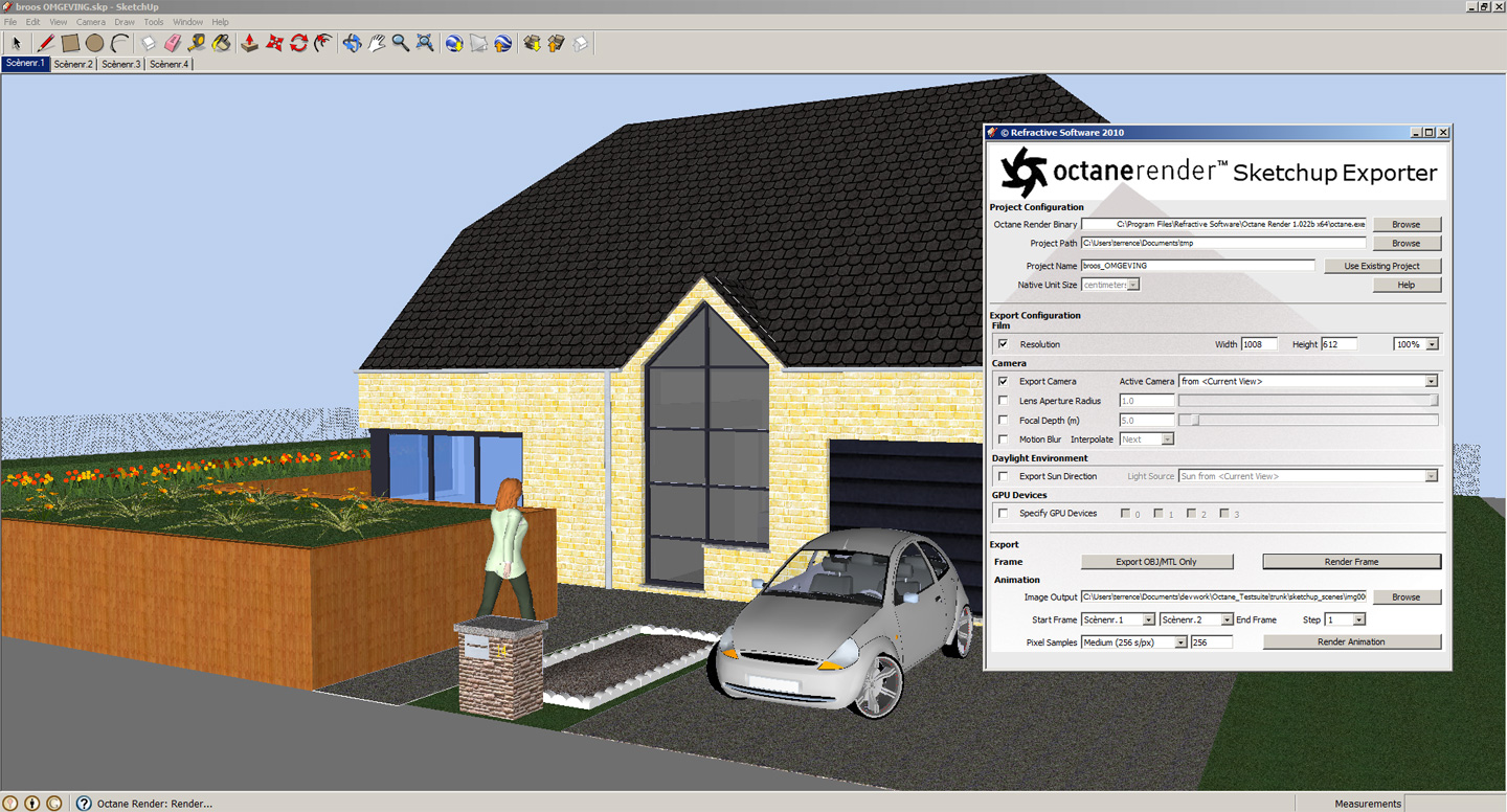

Here's my windows test.
Not a single problem ;)
The tickboxes are all correct to the guidelines.
The html bug is gone, which i used to have to press 'ignore' for.
Everything else seems to work fine.
Great work tig,
i think if you can get the mac version's tickboxes issue fixed, we have an official exporter ;)
Some shots, the original sketchup file and plugin with defaults:
original sketchup scene, octane plugin loaded with defaults, and i hit the render button

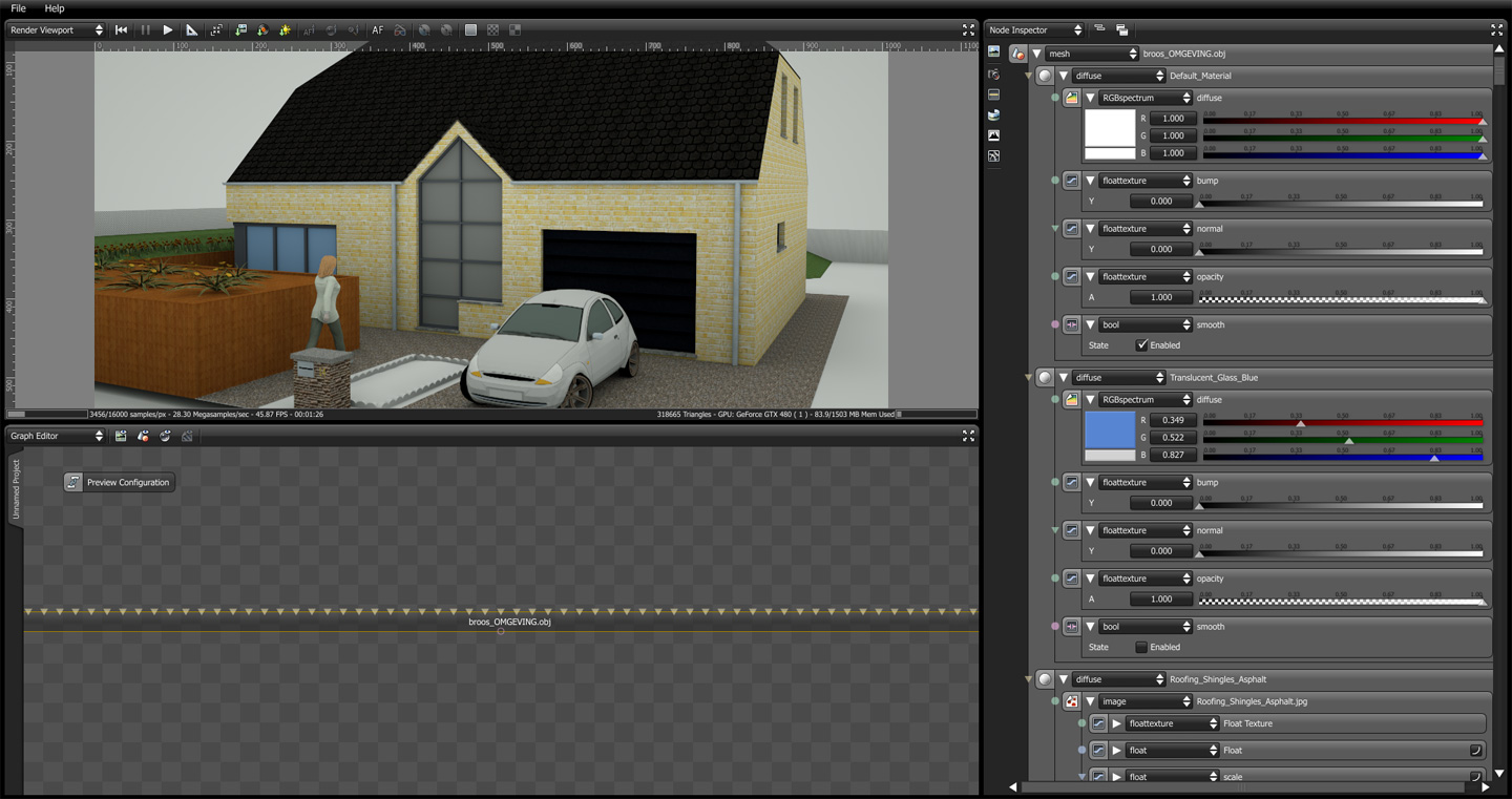

What it looks like in octane once the plugin has exported and launched octane:
Default imported materials/textures from sketchup, this what appears after sketchup starts octane

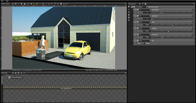

Final result, just 1 minute (with one GTX480 GPU), made a few small tweaks (not enough), this model is very light so i get a very high FPS and smooth navigation.
result, 1 minute tuning, 7 second render

There should now be no noticeable difference between the PC and Mac version of the dialog - the 'defaulting' of check-boxes etc uses the same code for both... BUT for some reason I have yet to fathom the Mac's use of the standard 'populate' code is still not working as the PC's :roll:
All functions should be available equally on PC and Mac, but the Mac version has gotten worse with the fixing of the PC js error messages... I might have to write a PC and a Mac version of the html code and try that.
Unsure about the font, size changes etc - perhaps a .css needs adjustment somewhere...
We've had a working PC version for sometime but the Mac version is still proving to be a real pain... I'll look at more tweaks... :( :?
We are doing two steps forward and one step back at the moment...
The GPU boxes should be unchecked and grayed-out if the main [left-hand] box is not checked, otherwise when it's checked they should become available for checking...
