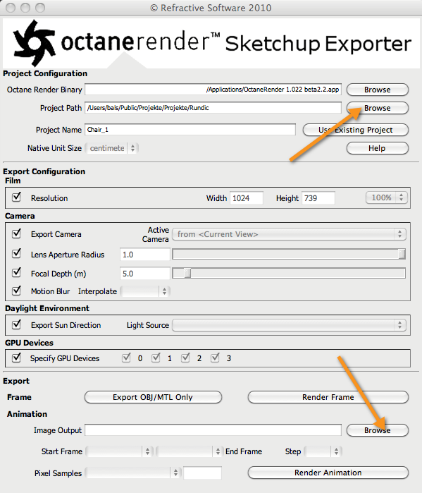

The browsers which are blank...and the checkboxes ...see attached
Yep, I've never tested these paths.
Nothings remembered, they all get checked again.

i already too posted screenshots about the not-working directory browser on OSX in the previous release posts.
it's just empty. (the browser window). entering paths manually in the main plugin textfields works fine though.

I am investigating how to make the folder-browser work with the Mac - it works perfectly on the PC ! It is relatively simple rb/html/js/css code and it's puzzling at the moment... :?
Quite separately - the default/checked boxes values are getting set properly within the ruby code of the tool but the final step of getting those displayed in the dialog is failing with the loading of the dialog's html/js 'populate' code. The html's 'populate' code as it was a few versions ago worked OK for PC and Mac, but it was found to cause [a relatively harmless but annoying] js error message for a few PC users before it then ran successfully: however, if it is changed so as to get it to work successfully on all PCs without this js error message [as the current version], then it fails to load the correct defaults properly for all Mac users ! :roll: So I need to find the solution that works for everyone... I'm working on it... :ugeek:
