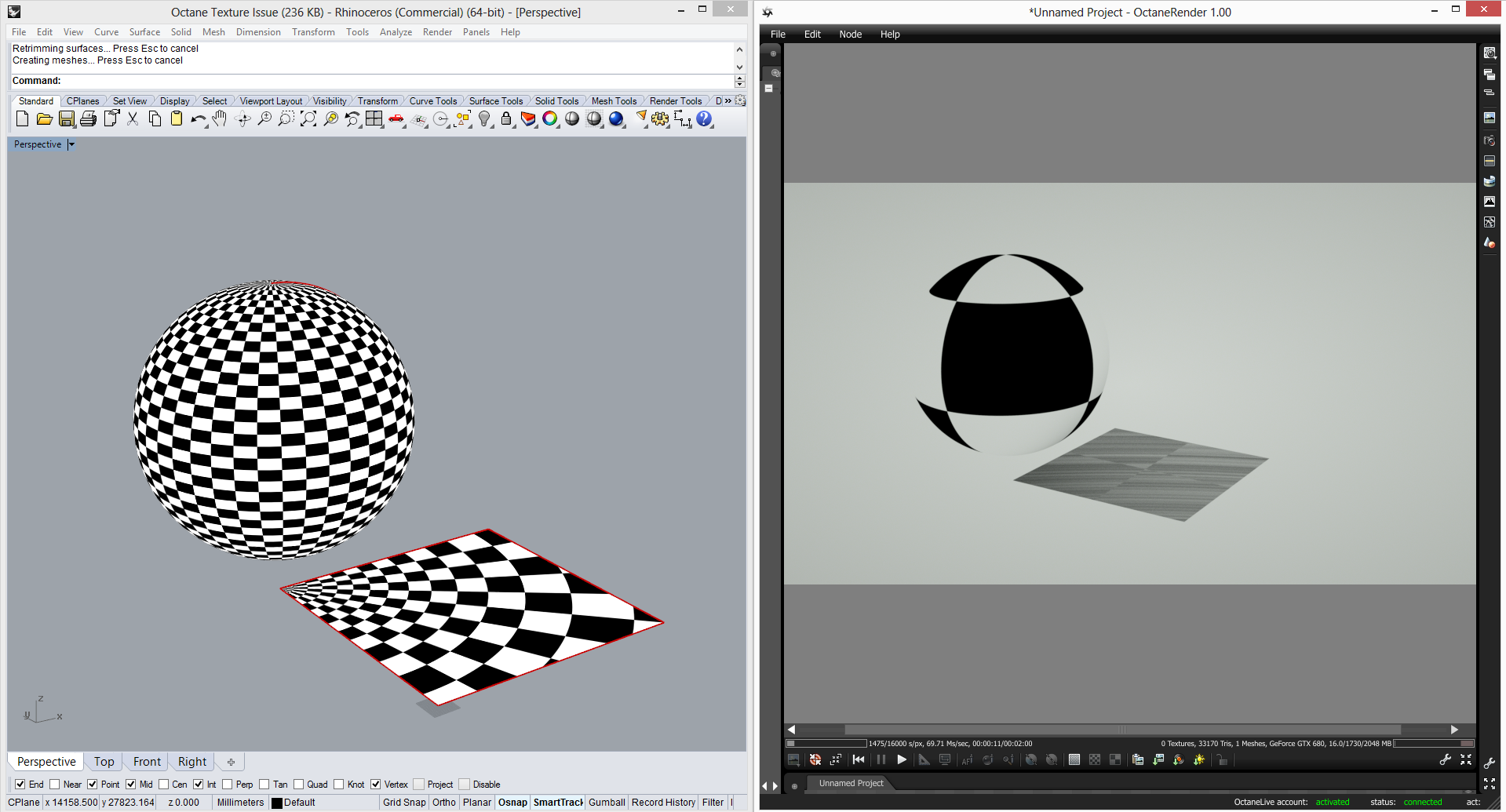

I'm having an issue where my uv mapping from rhino isn't being imported properly into Octane. I did a simple test to see if the OBJ file would work in Maya and it did. What am I doing wrong?
Rhino 5 to Octane Texture Mapping Issue
Solved.
I made a diffuse material with the diffuse color set to a checksmix node and apparently the checksmix node overrides the texture coordinates. When I eliminate the checksmix and use an image of a checker map instead it appears normal.
