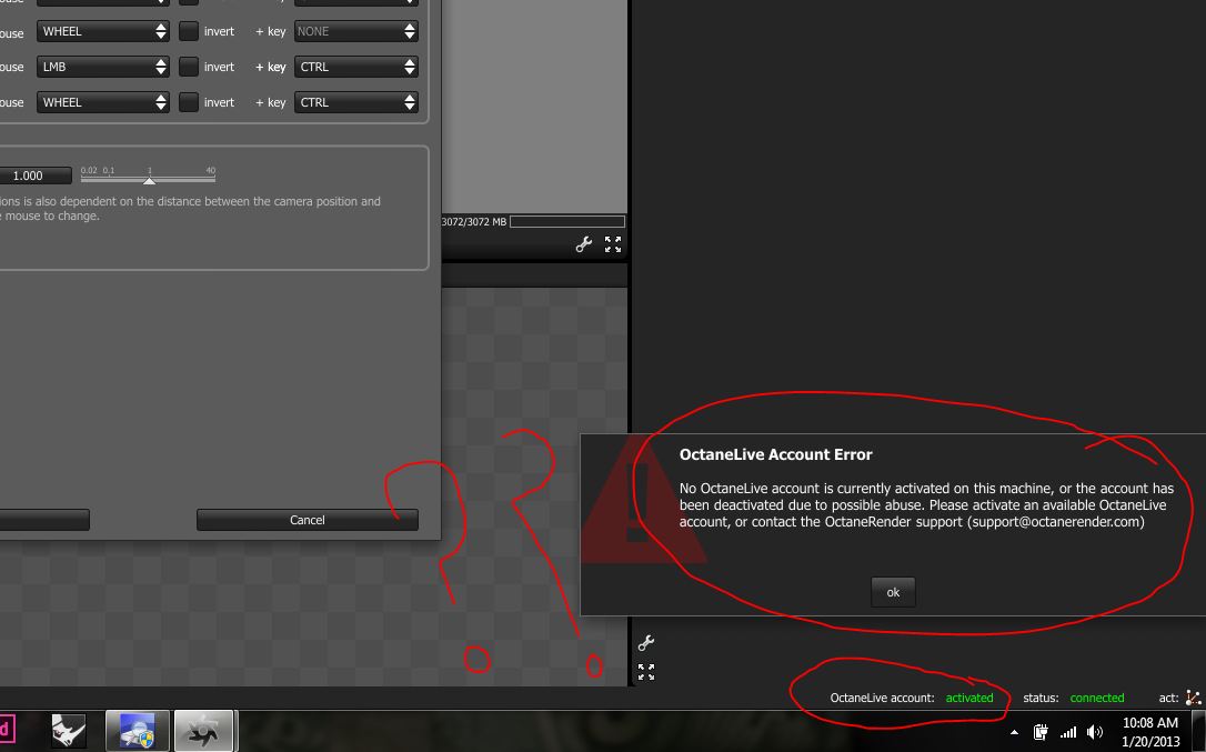

Hello, I purchased Octane yesterday and have been having issues with a pop up message that keeps telling me "OctaneLive Account Error". I followed all instructions and I'm at a loss for what to do...
The bottom right side of the Octane interface says "AccountLive: Activated" but the pop up message is telling me different??
Can someone please help?

I'm still not sure what is causing this bug, but I think we have seen it before. Could you please open Windows Explorer and enter "%appdata%" on the URL field at the top. There you will find a sub-directory "OctaneRender". Delete the whole directory and try to open Octane again. You will have to re-enter your credentials. Please do so and make sure that you don't enter any spaces or tabs. That should help. Let us know if not.

Wow.. It worked, Thank you so much. :D
