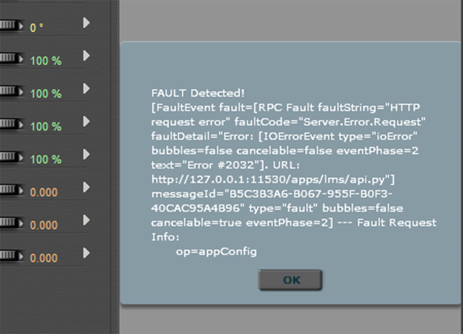

I enter password and on the right I get a FAULT Detected message ending with op=appConfig

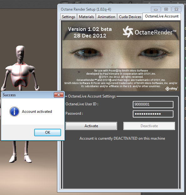

But the white boxed alert alert that pops up saying that activation was successful and then I click the OK button and nothing...
I can click on the other panel items like settings or materials, but it stays stuck on OctaneLive Account. I can close the thing and try again, but it just does the same stuff.... The OctaneLive Account tab continues to read "Account is currently DEACTIVATE on this machine.

The message occurs when I first click inside the password box (so that I can enter the password). After that the password is good, but I stay stuck on the OctaneRender tab of Octane Render Setup (1.02q) panel.

It is strange that this error is being raised during activation. It's an internal Poser issue. You can see details at http://forum.runtimedna.com/showthread. ... es-window!. In summary, the fix is to ensure you are connected to the internal, and that your firewall is letting traffic through from Poser.exe.
I wonder if your firewall is letting Octane.exe traffic through but blocking Poser.exe traffic. If that were the case, the activation call from the plugin might get blocked.

I don't see that the message I've been talking about is an issue in this --- I have the same issue (fault detected message) in 1.00m and it shows activated... when I re-installed it.
And in version 1.02q, it wants me to activate. and then I get the alert that says "success" - activated. But your panel stays stuck.
The program is talking to OTOY just fine, but I don't think you are seeing response (but you must have seen it, because you display the success alert.

If the "Fault Detected!" message is being displayed when you try to activate - then something is being blocked. If the plugin is not letting you select any of the other tab controls after activating, then it has not received a confirmation from the Otoy server.

I just double-clicked 1.02q. I de-activated and then turned off internet and activated, and the plugin gave a "cannot contact otoy, re-trying message" until I re-connected internet, at which point the plugin activated and I could select the other tabs.
I am reasonably certain the Poser "Fault Detected!" message means that there is a firewall or internet problem that is resulting in Poser indicating to the plugin that it's been activated, when in fact it has not.
Again, pls let me know if clicking the "Content" tab gets you the Content Paradise web page. And it's definitely worth reading through the runtimedna forum post listed above - since there are many people getting this error and the solutions are detailed in that post.

My uneducated guess about the problem is that you somehow trapped the other (earlier Poser) error, and so your code is thinking there is a problem when there isn't. Remember, the Poser alert occurs before I even hit the Activate button. Having said that, however, if I can clear up the fault detected message, then I agree with you that likely all will be well. Thank you for that link, I'm going to next see if I can get Poser to run more properly...
