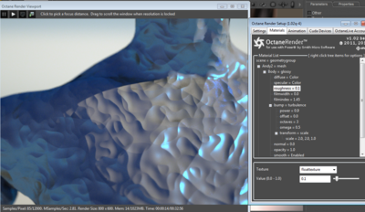

This is a 1 min test of bump and it looks OK to me - it's a turbulence node and it's very pronounced. Are you looking for a stronger effect than this?

I have to agree and almost never use image bump maps, even with 100% black and 100% white areas.
Depending on the type of bump needed you can plug a turbulence texture generator into the bump node and it works quite well and can be quite rough.
The other texture generators work too depending on the type of bump needed.
