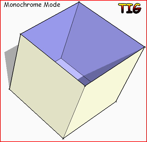

The main issue with that SKP was that there were many faces turned the 'wrong way round', so that the faces' fronts were looking into the building rather than to the outside.
Note how when I fixed the SKP I used Monochrome mode to spot the reversed faces, then simply sampled each face's material, reversed the face and reapplied the texture to its 'front' rather than its 'back'.

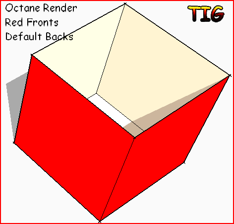

The "back" of a face is always rendered by Octane in an "off-white" 'default color'. When the user has incompetently applied a face's color/texture to its back-surface, which he has made to look at the camera by mistake, then that face will not show that color/texture: the front of the face will be colored/textured as the user has determined - but it might well also be left in the SKP's 'default-front-material' and/or it might just be looking into the building or into the inside of an object, and therefore it might never get to be seen.
Octane ignores back face materials, quite sensibly, and makes them 'off-white'!

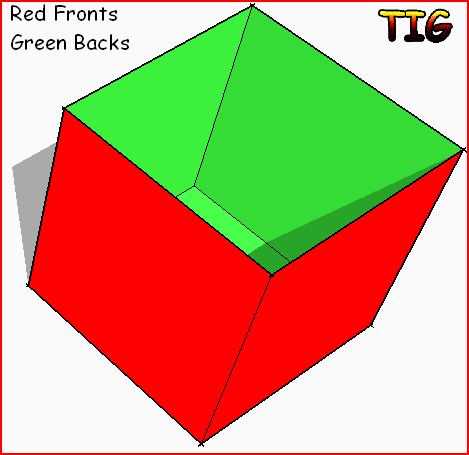

For the avoidance of doubt/confusion let's consider a simple example...
A SKP user makes a cube with an open top - i.e. a 'box'.
Its faces all look 'outwards'.
In SUp's Monochrome mode the 'outside' of these faces look 'off-white' and the inside faces are in the 'blue' default-material color.
Now the user 'paints' with his desired materials.
The outside [front] faces are colored 'red'.
The inside [back] faces are colored 'green'.
After an export and subsequent render [in Octane] he'll get a 'red' box - but where the inner surfaces are visible they are shown 'off-white' in the render, as 'back' surfaces are not rendered.
Remember that SUp is face modeler - it doesn't model "solids"... but planes with fronts and backs.

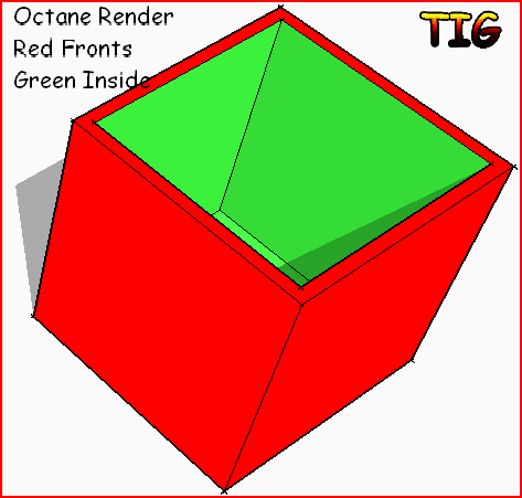

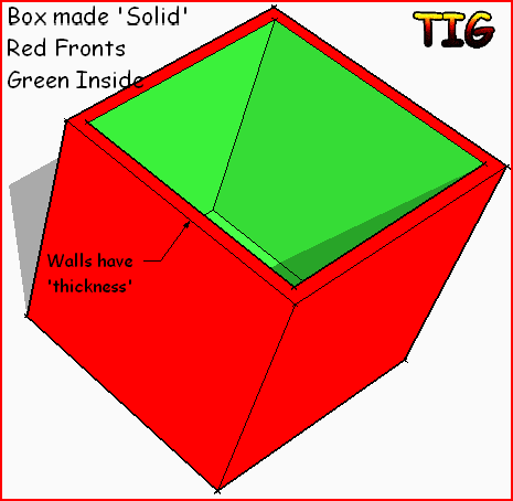

If the user really wants a solid box with a 'red' outside and a 'green' inside then it is quite simply done...
He simply gives the box walls with a thickness - just as in the real world [remember that even a sheet of paper has two 'faces', not one 'face'].
Then any materials that are applied to the box's walls front-faces will export properly and then they'll render as a red outside and a blue inside.
