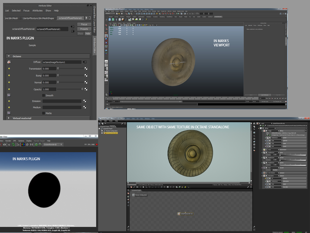

Hello, I don't know if I'm doing anything wrong, but I created an obj.
I created the UV's in Maya, then I painted a texture in Zbrush. I flipped the image in V and saved it.
Now I can open the object in the Standalone version and apply the texture and works perfectly.
But when I apply the very same texture to the very same object in Maya I get a black object, no texture.
The texture is completely visible in the shaded view in the Maya panel.
Thanks in advance for any replies, suggestions!!!

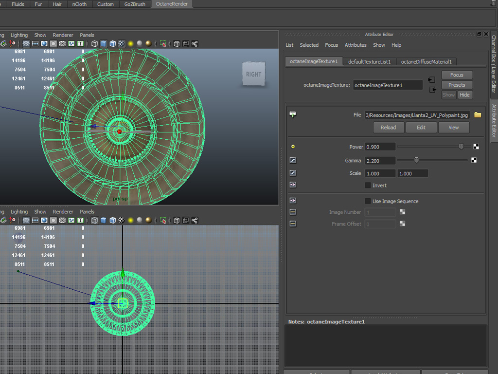

Can you please post here the screenshot of attribute editor with "octaneImageTexture1" settings in Maya?
Snoopy
Posts: 59
Joined: Sun Dec 04, 2011 4:20 am
Thank you for the quick reply JimStar!

I can't see the full filepath of the structure in Maya settings, can you check that it does not contain the national symbols? Octane will not render such textures...

PS: If that's the problem. Why is it possible to render in Octane Standalone ?

Hello JimStar, I did what you suggested, I moved the texture image to another folder and now it works!!!
THanks a lot JimStar!!!
