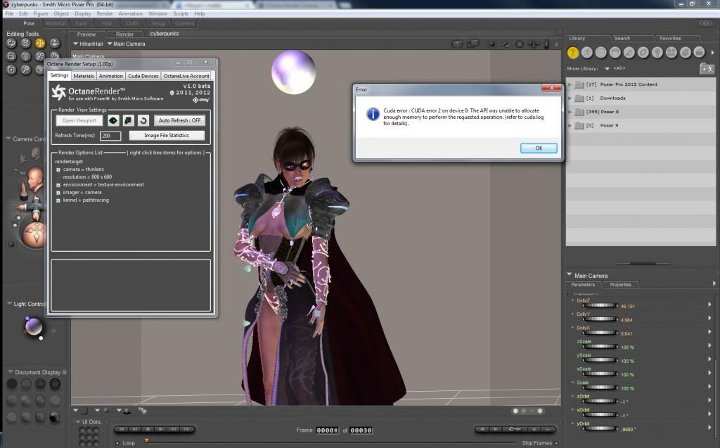

ch0pper
Posts: 405
Joined: Sun Dec 30, 2012 9:31 pm
Location: uk
after going back to version 1.00p
now geting this error
W7 64 bit |I7-3970X | GTX 780 X2(6GB) GTX 780TI X2 | 64 GB DDR3 RAM

The Quadro 5600 is quite an old card based on a GeForce 8800 Ultra.
Its general level of performance for gpu rendering would not be very good having 128 cuda cores.
It also has cuda Compute Capability 1.0. It may not be so suitable for recent Octane builds but the Otoy guys can advise you about that.
Which Nvidia driver are you using at the moment?
How many polys has your model?
Try closing some open apps and turning off Aero to free some vram

Also try to reduce the texture sizes.
Often they come in a 4000x4000 resolution, that's usally not needed.

I am pretty sure that Octane 1.02 will only work with GTX 500 and 600 series cards at the moment, so for the moment you should use the 1.00p build of the plugin. If you are running out of memory check the FAQ thread in this forum for tips, including using the texture file compression script supplied with the plugin.
