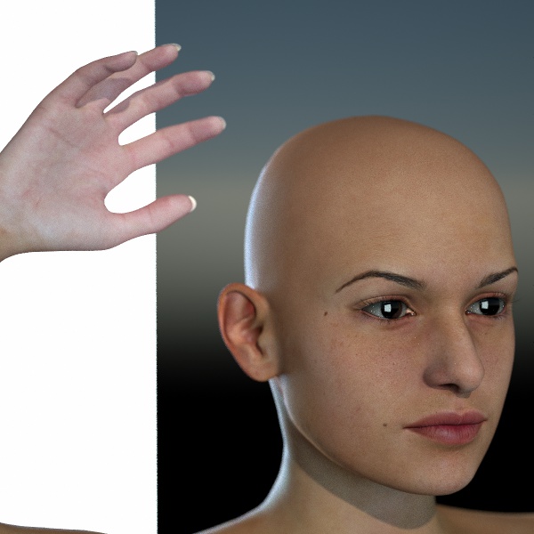

Hi Uwe,
Ok, so the depth of the scattering is then determined by the division of the scattering setting and the scale? I used 0.5 where you have 0.09.
I found the value of 50 through trial and error (best item to look at were the hands, I tuned the parameters until I got a slightly reddish effect on the fingers but not on the palm).
I read through your post and I agree that the color of "transmission" is crucial - with everything else same, this can give you anything from a yellow-ish ill-looking face through normal and towards a blushed appearance.
In the picture attached (DAZ Reby Sky model), I used a map for the transmission color (EC). I first tried to use the transmission strength maps (ES) as well, but then through that Octane would give me that though volumetric effects (material thickness), which I think is not available in the programs they made the maps for.
Right now I think the skin looks still a bit "dry" and uniform. A specularity map should help here, controlling specularity and roughness of the glossy skin component. While the Spec maps of most textures seem to be just a darkened version of the desaturized diffuse maps, RDNA's Vanilla Sky has some maps which could by suitable.
I have not yet tried to adjust the direction parameter, will do that later.
Best regards,
Michael

For your render - the scale looks too small - since there is no SSS around her nostrils or fingertips.
For specular - use filmwidth 1 and tweak to specular (to get the amount of reflection) and roughness (to get the texture). A turbulence node might give you best bump than the bump map.
Also, gamma 0.8, exposure 1.2.
There is a feature of the next release that will make this easier to tweak - you can display the previous render - so it makes it easy to compare results.
Paul

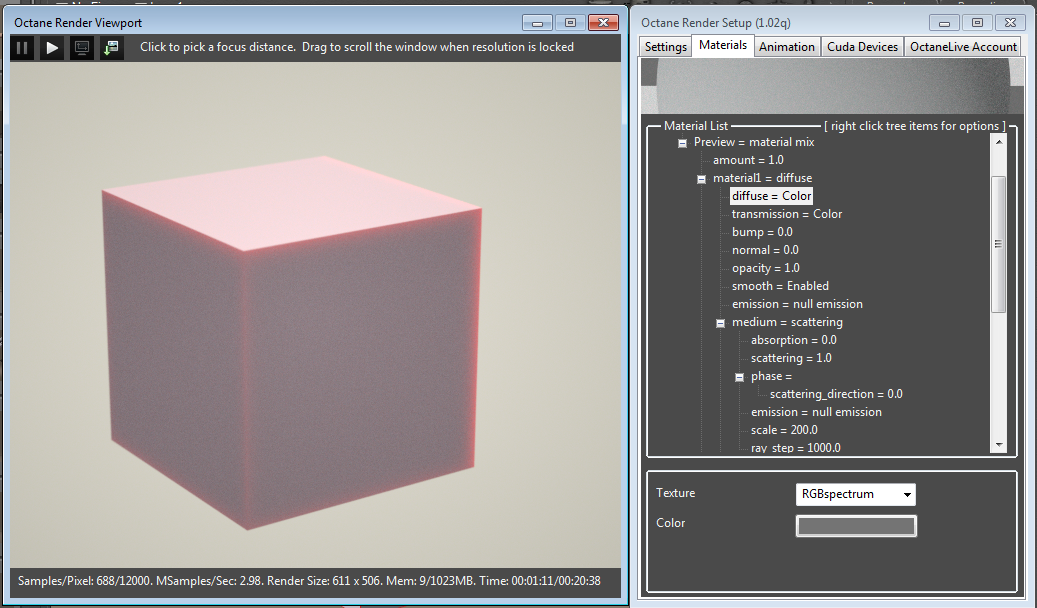

I just had a few mins to play with this again.
Absorption is absolutely key - it needs to be non-zero, otherwise the sss leaks to all parts of the mesh. Attached image shows 0 absorption - you can see the whole box is tinted red (undesirable for skin).

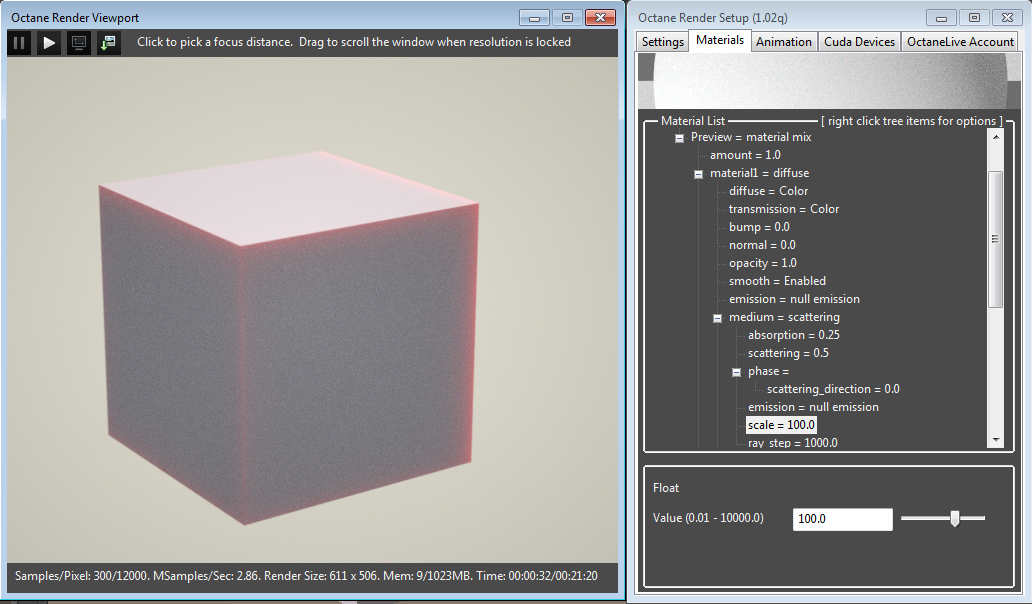

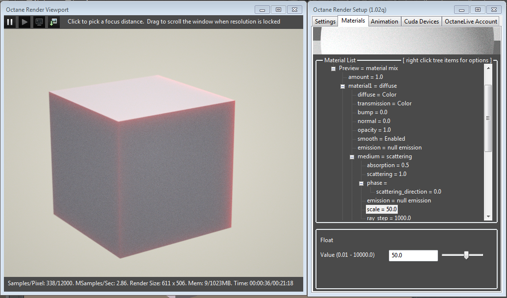

Now add some absorption, and you still get the sss effect at the edges, but a neutral colour elsewhere, which is what you want for skin.
NOTE: Both these render give the same result, but one has sss and absorption halved and scale doubled. So you can see how I came to the conclusion that it was the ratio of the scattering to absorption * scale that dictated the sss effect.
