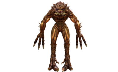

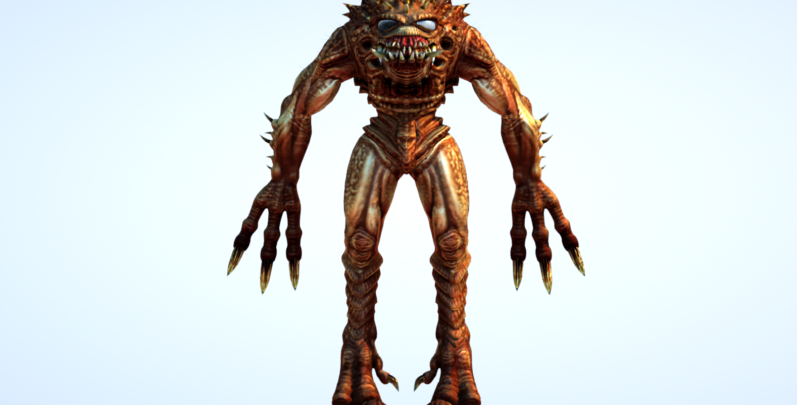

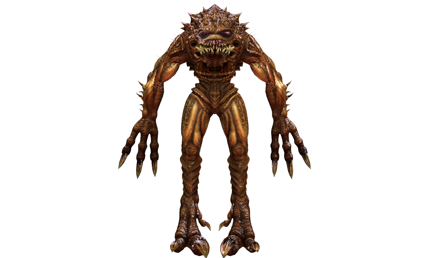

I would like to see the implementation of materials transfer that represent exactly what is in the Poser settings. This would solve a great deal of issues I have. For example... When I render figures with textures that are glossy and or reflective Octane does not recognize the way poser has them set up.
Examples: The first creature was rendered in Poser with glossy settings to the textures. The second is the same shot with Octane, set to glossy. However, the images do not have the same specularity even though they are under a similar DAYLIGHT lighting. If the Poser settings would transfer directly to the Octane render settings, then it would be much easier to get the same results. I had to manually load all of the specular and bump maps into Octane, and they then need to be adjusted to get the same glossy look of the Poser original. Not even sure if that will happen... but I suspect it will take some additional tweaking.
The plugin does not try to disect the nodes from the Poser materials. Instead it brings across the diffuse, bump and trans maps, and converts these to Octane diffuse, glossy or specular materials according to a set of rules which are detailed in the plugin manual. You can control the conversion to some extend by tweaking the parameters in the OctaneDefaults.py file. Bump map files are automatically bought across from the Poser material. Specular maps are not. One of the issues with specular maps if that the Poser nodes might invert a specular map (or do some other operation) such that if just the specular map was plugin into the specular Octane pin of a glossy node, it would look terrible. In the long-term, the above system will save you a huge amount of time over a system where you have to fix up conversion issues resulting from bringing across complex Poser node setups.I would like to see the implementation of materials transfer that represent exactly what is in the Poser settings. This would solve a great deal of issues I have. For example... When I render figures with textures that are glossy and or reflective Octane does not recognize the way poser has them set up.
For the example you provided, tweak the Octane nodes for the figure, and then save the material as a preset for future use. And also save the Octane material back to the Poser material, and when you next load that figure, it will have your tweaked settings.
I'll add this to the list, but it will mean the plugin flipping the texture and saving it in the temp folder, and using that modified map in the Octane "image" node. Given the relative rarity of rotated images in Poser materials, I would put this as a low priority, so unlikely to make the next release (or two). The easy workaround is to simply manually rotate the map using Photoshop.Image rotation. True rotation is not directly supported in Poser either. But a 90 degree rotation (exchanging x and y) would cover most occurrances. Easy for me to say, not sure if it can be done in Python
