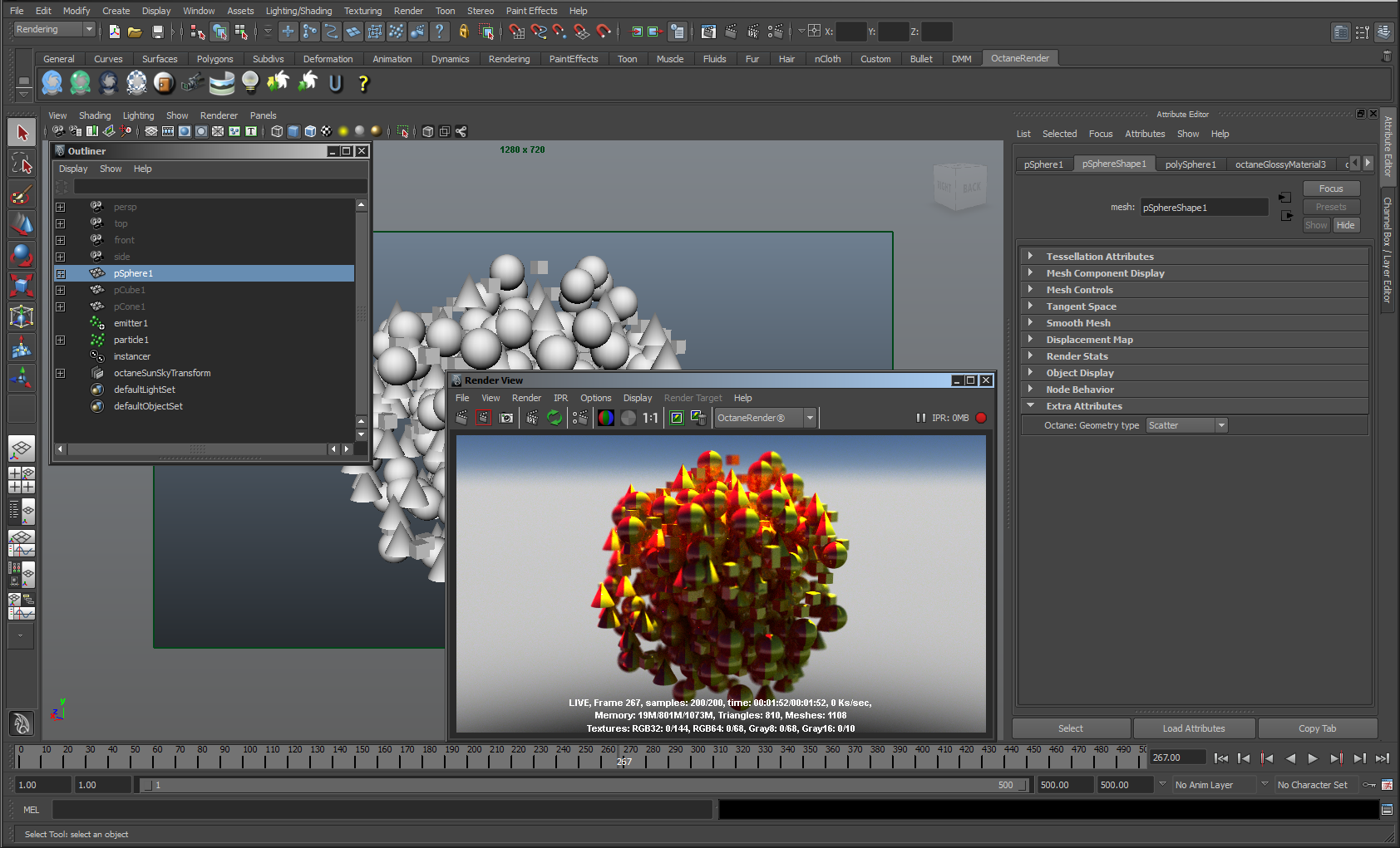

since OctaneRender® for Maya® v1.0 RC3a beta if particle instancer set type: Movable proxy or Scatter, assigned geometry materials is disappears and render instancer in gray material.
With OctaneRender® for Maya® v1.0 RC3 - 1.0 everything was fine.
Many thanks for OctaneRender® for Maya® v1.02 beta, but the same problem.

ypolyz wrote:since OctaneRender® for Maya® v1.0 RC3a beta if particle instancer set type: Movable proxy or Scatter, assigned geometry materials is disappears and render instancer in gray material.
No problems at all with it on my system, can't reproduce...
Can you please describe in detail how do you set it and/or give me the scene?..

ypolyz
Posts: 21
Joined: Thu Apr 05, 2012 2:09 pm
Yes, send.
Test_Particle_Instancer.rar
(660.72 KiB) Downloaded 290 times
