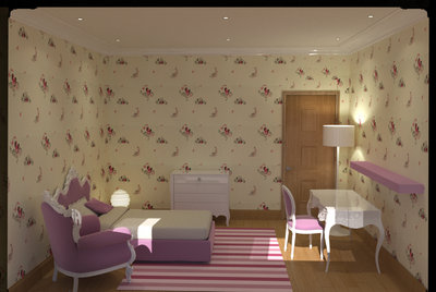

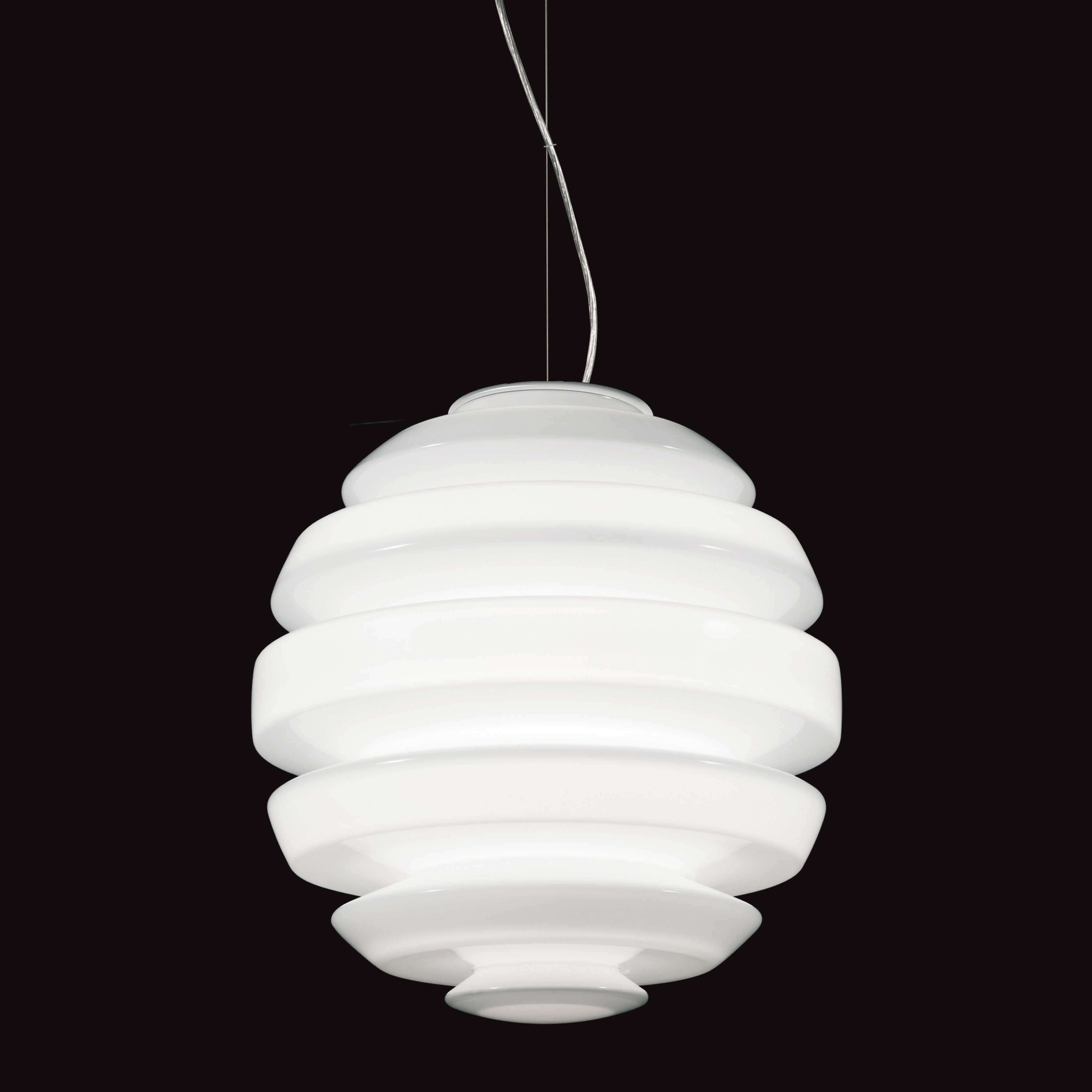

It's a glossy lampshade... here is the reference photo

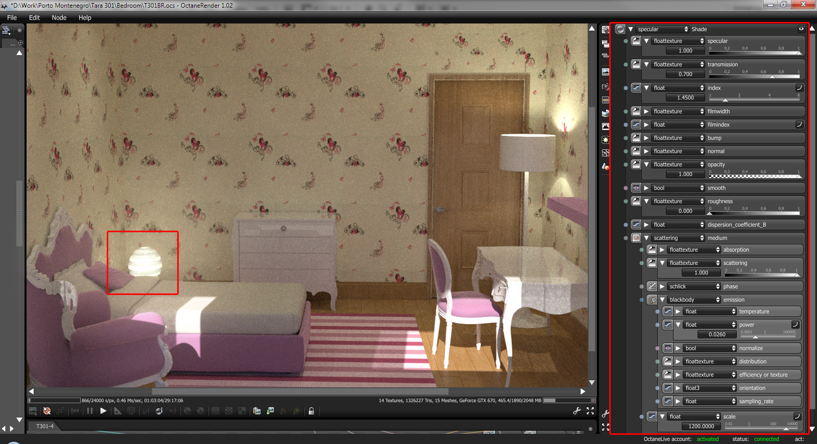

I have a simple question .. if you can make this material please tell me the most efficient way to do it
now I use specular SSS but I added a little bit of emission inside Medium node....
Glossy SSS material
Glossy SSS material
with the help of POST PRODUCTION. I use 2 images and create a layer in Photoshop and combine them... (the result in the render window is already combined)
I appreciate a lot for the help :)

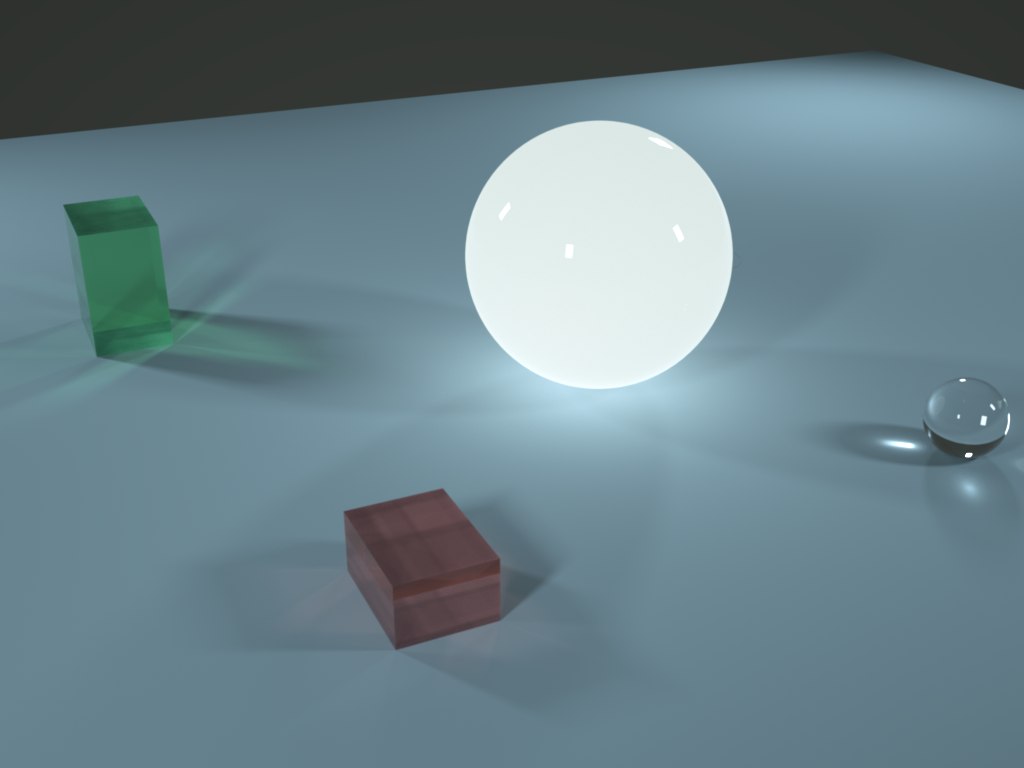

oguzbir created one if you want to use it, check the link to see if it's what you need.
http://render.otoy.com/forum/viewtopic.php?f=5&t=25737

MaTtY631990 wrote:oguzbir created one if you want to use it, check the link to see if it's what you need.
Thanks :D
I will try this and post the result tomorrow !

mix material Glossy Material + Diffuse Material + emission

Elvissuperstar007 can you share your material setting ?
your "Glossy + Diffuse + emission" means Glossy material + "Diffuse material with an emission inside scatter node"?
I would like to try your MIX style :)
