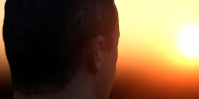

In response to the above 2 comments....where in Poser we are used to adding and tweaking lights imitate real life lighting, in Octane it's the opposite - just use the real lights! Think like a photographer, not a 3g person.
An outdoor scene will potentially use the sunlight lighting (in the environment node) and won't need any Poser lights.

An example of an outdoor scene lit via the sunlight system.
