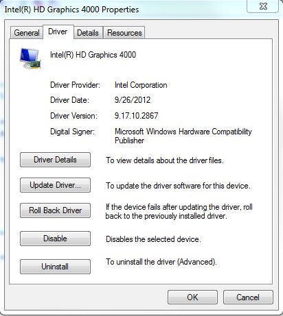

Hi Chris thanks, I think I do have the latest drivers here are the properties. It think it is my Apple display that is the problem.FooZe wrote:1280 x 800 doesn't sound right to me. This is an HD4000 right? Is windows showing this as a standard VGA adapter? You may need to install the correct drivers from intel - this will give you full resolution and multiple monitor support.

I ran a 3770K with HD4000 and 2x 580s on a cinema display with no problems mate
