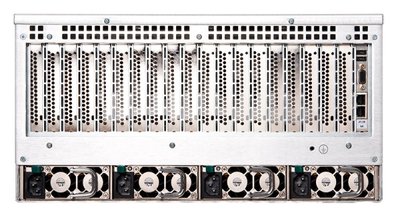

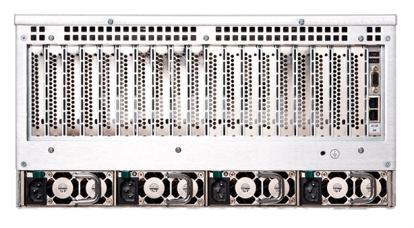

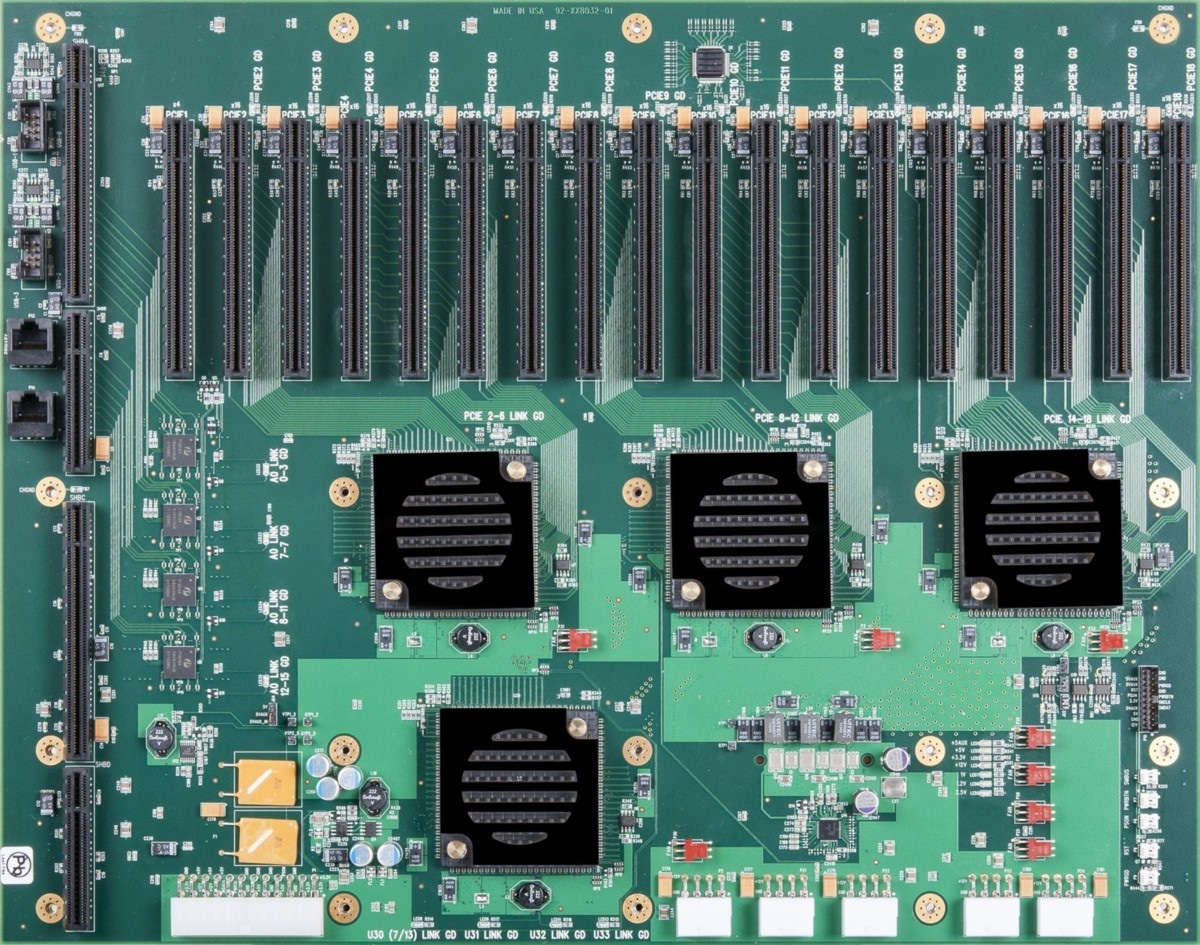

I was googling around the other day, tripped through bitcoin forums..after a while I found a company, that makes some amazing products =) & here's one of them
”..the BPG8032 PCI Express 2.0 backplane redefines the world of PICMG 1.3 slot-based servers by maximizing PCI Express I/O expandability...For high-performance GPGPU applications, this backplane supports up to nine NVIDIA Tesla 20-series GPUs for cluster computing applications inside a single 5U, 19″ rackmount computer enclosure when using the TSB7053 single board computer.“
post itself: http://blog.trentonsystems.com/new-back ... -2-0-slots
backplane BPG8032: http://www.trentonsystems.com/products/ ... ne-bpg8032
& their SHB, TSB7053: http://www.trentonsystems.com/products/ ... 13/tsb7053
just sharing if anyone is geekly interested in these kind of things..apart from the price =)..it's actually amazing how much of a power You can pack into one system =)
17 PCI Express 2.0 x16
so you will need 3 psu s and a high voltage current

why three, when You can have one more for redundancy! =pRefracty wrote:so you will need 3 psu s and a high voltage current
http://www.trentonsystems.com/products/ ... er/trc5005
actually it supports 17 x16 PCIe 2.0links..but it would be only possible to stuff cards if they had single slot design..bepeg4d wrote:wow, with 9x 690 you could have 18 gpu for octane![]()

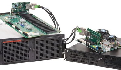

p.s. if You wouldn't like to use SHB, there's an option for PCI Express Expansion products.
http://blog.trentonsystems.com/pci-expr ... capability

This is very interesting. If I understand, you just have to connect the big PCI backplane to your computer with the PCI extension cable and it works ?

The space of the PCI slots seems to be important, you can only put ~8 video cards on the Trenton 17 slots PCI backplane because cards like a GTX or Tesla are thick. Some backplane have PCI slots more spaced because of that : http://www.cyclone.com/products/expansi ... /index.php

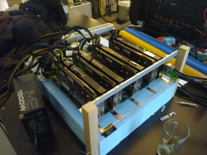

we got one of these a couple of weeks ago when we were in a hurry to do an animation. the deadline was that near (like two weeks) we decided to invest a part of our salary into such a thing.
it's really rock solid manufactured and trenton's support is amazing.
it's connected to my host via 3m cable, the host itself has another two gtx 680 and one tesla m2070, all three water cooled. the animation was rendered out with arion but will probably behave equally with octane (testing right now). We did not notice a significant bottleneck of the one to four pci configuration.
we need those 4gb per card that's why we've chosen the gtx 680. One good thing about those gainward 2.5-slot design is that their cooling is astonishing. placed like shown in the picture their temperature won't exceed 60 degrees celsius and therefore the fans stay really quite. no need for watercooling.
the future plan is to put for example 6 cards directly on the backplane and another 6 on top of them using pci riser cables.
unfortunately my Asus P6T7 won't be able to address all those cards an won't boot. see http://fastra2.ua.ac.be/?page_id=214 for further details.
So what we think we need then is a host board with a bios that is capable to address devices above 4gb space (64bit). preferably a UEFI bios board. this we will test soon
another open question is: will nvidia drivers allow to have say 14 cards on one system? I contacted nvidia support via chat, the guy said that there is no built in limitation from driver side. but that's no guaranty for me and I haven't found a windows system on the internet with more than 8 cards yet.
another thing to consider:
- the bottleneck in such a system will probably be the bus between host system memory and processor(s). therefore I believe a dual processor board will be an advantage to handle the traffic to/from the memory blocks because there are then two lanes and not only one.
