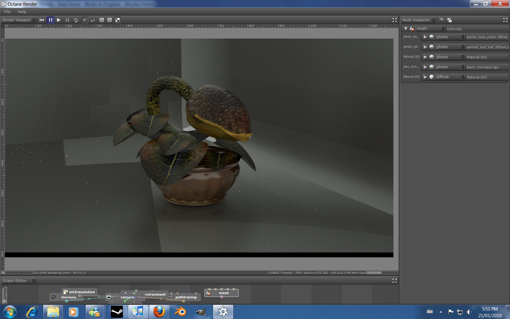

4) Another strange glitch happens randomly in the Viewport. Even if I import very simple meshes (a big half-cube, for a room), depending on the angle of the camera, certain parts of the object get "grayed" out and flicker... They render this way too. It can completely ruin a scene.
I've attached a screenshot to show an example of this (though a video would make it more clear).

regarding the artifacts in your render,
either your model is way too big or way too small.
one unit = 1 meter, and if you're modeling app works in milimeters or centimeters, after you import you're model will be kilometers large and you'll get these shading issues.
use the unit conversion in the FILE -> OBJ Import options to change it.
also make sure you haven't got the smoothing enabled on meshes like cubes/walls/boxes as this gives normal smoothing with large angles and then you get these problems...

Adjusting the scale has already helped a great deal - no more artifacts. In case it helps anyone else, I was importing from blender, and am having more success using the decimeters to meters conversion factor.
