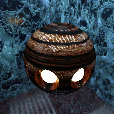

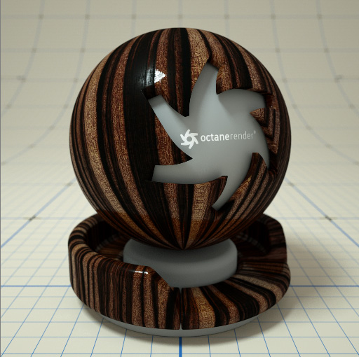

I made a little funny testscene after i saw the animation on the vimeo channel and wanted to apply my wood Texture (live DB - 1st Wood) at the Sphere. I saw the Texturing is different, than in the render preview. Look at the Pictures and you see what i mean:
Obviously there is something different with the UV Mapping i did in Rhino. I tried to rotate the Texture in Octane (Standalone) or to change the kind of how the texture shall be mapped. In Keyshot this is very simple to do - you have about 6 different types how to map a texture on the object.

just apply a spherical mapping in rhino
Yeah, you'll have to map your UV excatly in the modeling app, because Octane cant do anything with image textures (except uniform scale).

Refracty i know that i can do this in Rhino -
my question was how can i change this directly in octane? This MUST go. i can´t allways go back to rhino, change uv, make obj and import new....this would be competely useless. this must be possible in octane too. i just need to know how
In keyshot i just double click the Material - change the way its mapped - done. How can i work like this in octane?

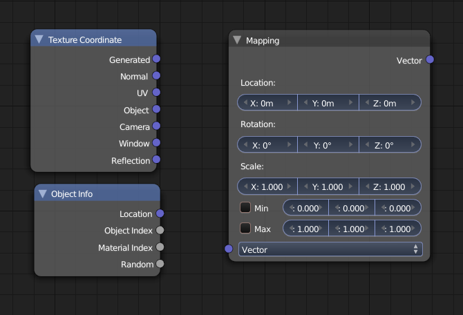

I'll put this graphic to illustrate a few points (if any developer is reading this):
1.) We need to be able to pick a coordinate source for some texture (UV, world global, object origin...)
2.) We need to be able to pick a projection for some texture (cube, cylinder, sphere, flat (when source is UV),...)
3.) We need to be able to fully transform these coordinates, with a transform node (scale XYZ, translate XYZ, rotate XYZ)
4.) In case of instances we need to be further able to diversify texture mapping by some object (instance) specific data, like: randomly generated for each instance, by it's position or by some other arbitrary data read from the .cvs (supplied by the modeling app)
