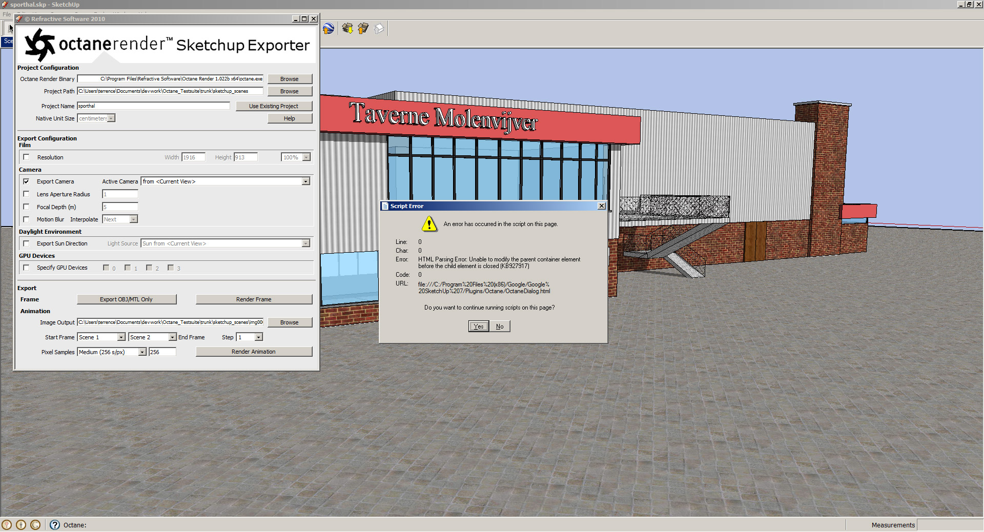

I just installed the free version of sketchup on my windows 7 PC with 2x GTX480,
and i loaded the plugin. (BTW, can you include a installation document with it ? like an install.txt or readme.txt ? it was difficult to find the correct post here where there are installation instructions)
After starting sketchup and loading a scene i got from a friend, i found the 'Octane' in the file menu (can this be changed to 'Octane Render' ?),
and when clicking on it i got the following error.
I just clicked 'yes' and from then on it worked, i managed to configure it and hit render and octane fired up nicely with the model loaded ;)

The java-script error relates to the dialog - I note that you are on XP - it's been tested on Vista without error messages - what version of Internet Explorer do you have? - please try to upgrade to the latest compatible one, and retry... I know older versions of IE cause some glitches...
There is a PDF is the Octane folder inside the zip that covers installation - I could make a simpler README.txt file at the base level too if it helps...
It can be called 'Octane Render' if preferred. It's in the File menu because that's where other Exporters etc are found, I avoided putting it into the Plugins folder as that can get cluttered and you'd get easily overlooked in there... It's up to you...
I can change the name for the next version, I also need to link the help file for Mac as well as PC etc...
Wait to hear about the Mac trial...

TIG wrote:Radiance
this was actually done on a windows 7 x64 machine (with the fancy UI turned off, as i don't like it).
default setup with default IE (as i never upgrade it, i use google chrome)
Radiance
