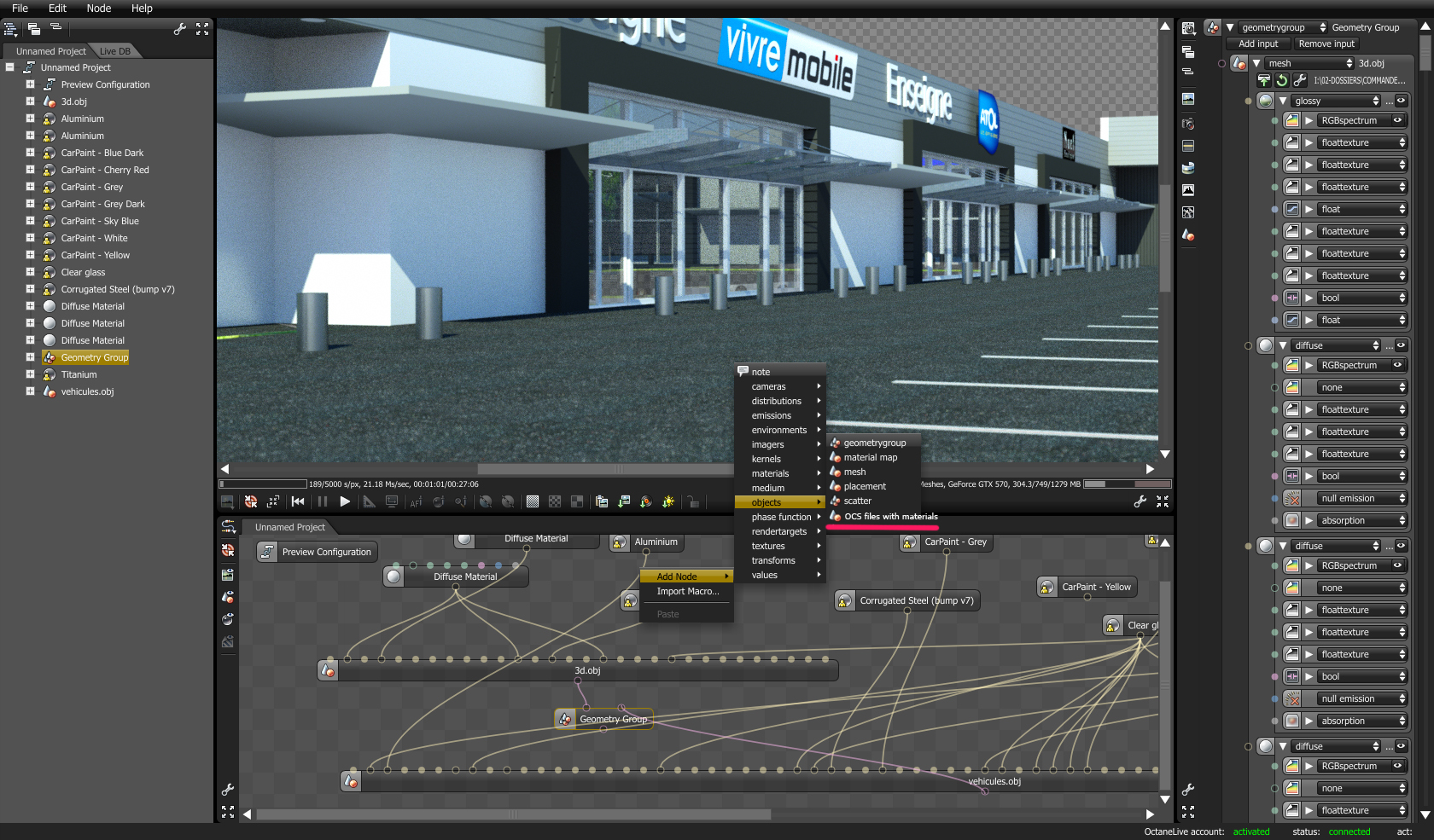

IN octane how to combine two files OCS together?
Ex: I 2 files, one with a building, other with cars
I import into a new blank file the other 2 files (such as REFERENCES) XREF on autocad.
preserving materials for each file. Is it possible?
Thank you for your answers.

I understand the instances, but I do not want to repeat the material each time, I would use 2 files OCS.
In my example: I have a file ocs building and the other cars, I would use these cars for different buildings without duplicating materials, with instances we can only import OBJ files.
Ideally it should be in the file menu to add file with OCS materials.
Isn't it possible to copy the nodes from one ocs and then open the other ocs and paste the nodes there?

Open 2 windows of Octane, each one containing your 2 OCS files.
& just copy / paste.

Thank you very much, I did not think to copy and paste.
But I think it would add to the menu line with OCS import material. is better.
+ as a typical menu autocad Xref.
We can work with several people.
