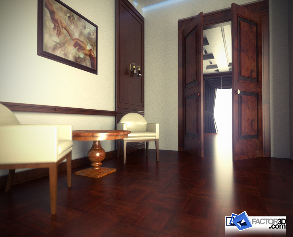

The curtains ruin the image. Nice wood texture on floor, but i miss something... Maybe bumps?
And the 'dirt' textures on the doors might be too overruling... Did you look at photographs of old doors like this.
The scene has potential and I like where you are going, but details are missing.
For instance I miss the baseboards (wall/floor) that cannot be missed in this style house.
It looks like there is no space between the door and the floor?
Curious for your next update
Greetz

Yes, its a model imported from sketchup. The curtains are not smooth at all and that catches the eye more than all. For the bumps on the floor, I don´t do that, I like more a smooth surface in that wooden floors.
I´ll keep your advice for future works, thanks

really nice, for me they are perfectly light balanced.
Prefer the ernders with the texture gammacorrected.

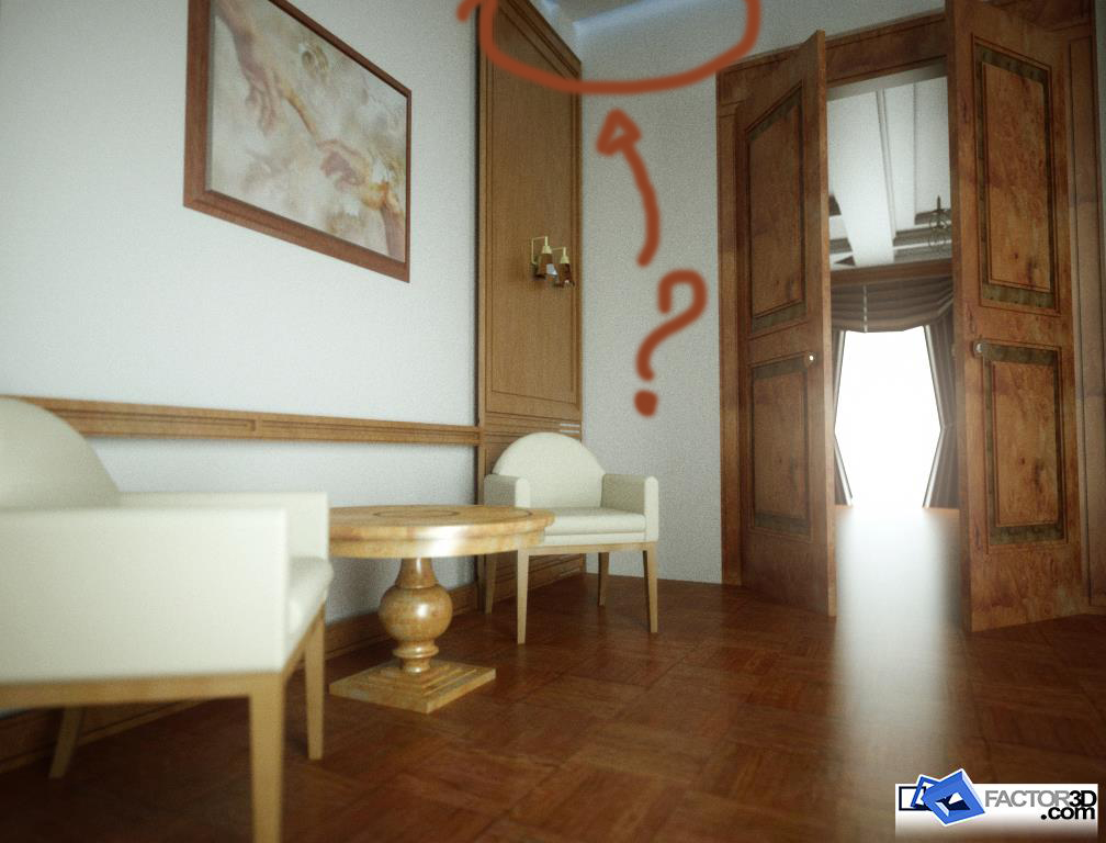

How did you set up the illumination?...What is the strange beam ner the ceiling?
Would be nice to see the raw images (without post processing)
Cheers, paolo
Cheers, paolo

That´s a strange color bleeding, not sure where it comes from. I guess there is some area not covered in the ceiling or something letting the exterior light pass through. Should not be there.
The illumination is the simplest on earth. There was a second layer of curtains in the windows, covering the window hole so it wasn´t practical to put portals or something, so I made the curtains an emitter, thats all. Some exposure tweaks made the rest, that was enough.
