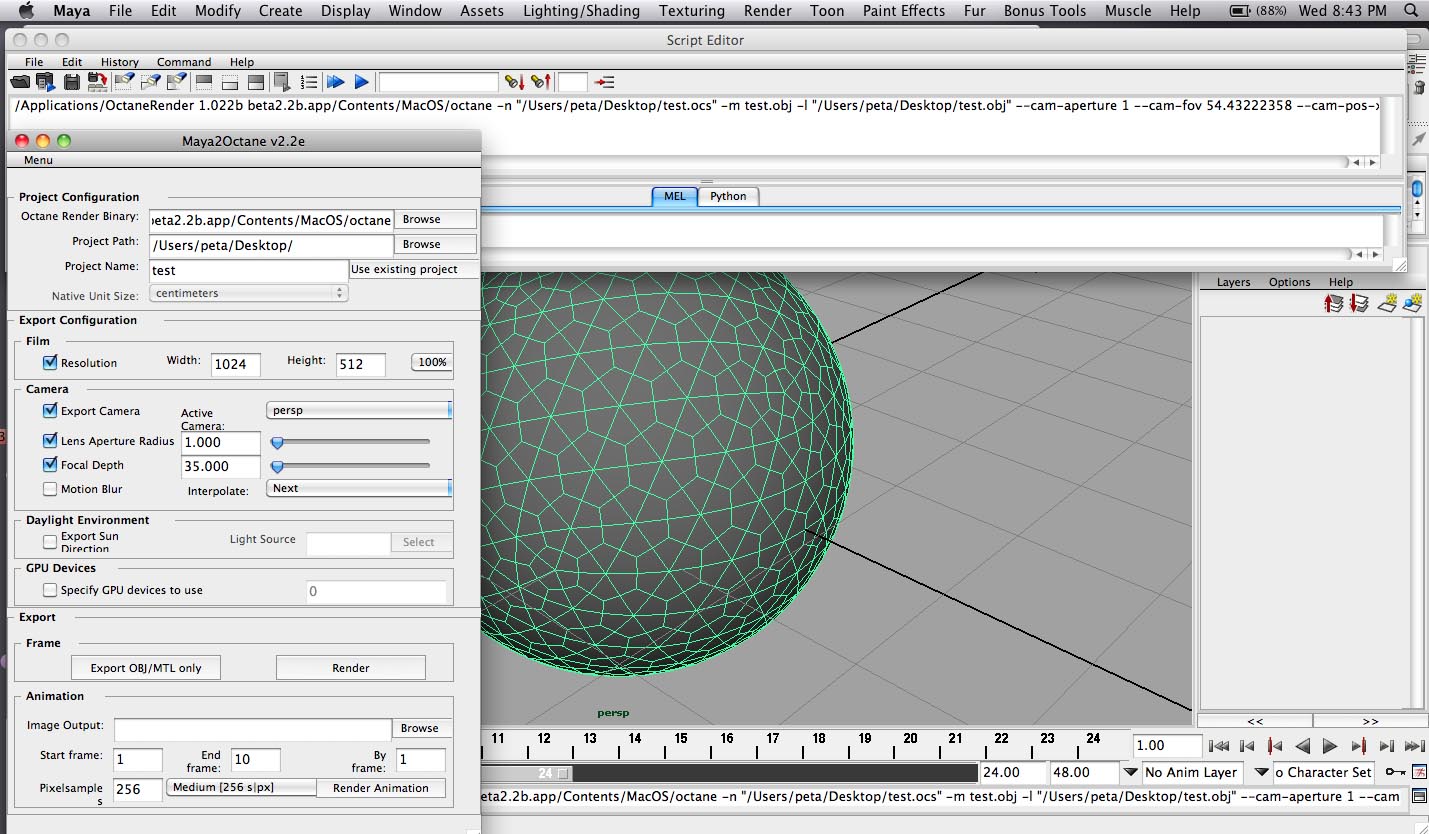

Here is a screendump... you can see its all pointing to the right place and no errors
Peter

can you try copying the octane executable from the location the package installed it to another path that does'nt have a space in it, then change the path to octane in the plugin config ?

Thats seemed to do it. I just took teh spaces out of the App Name and up she came.

hm, let me check but i think that cgbeige also has osx and i think he doesnt have any probl with paths, let me also ask him about that probl...
i see that the path to main octane file is with out quotes, ill check that...
