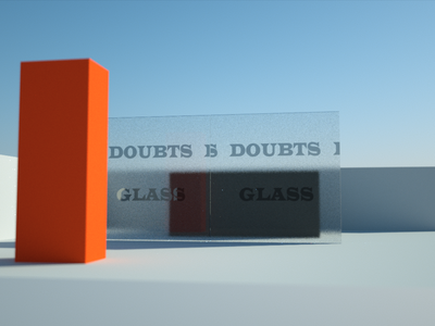

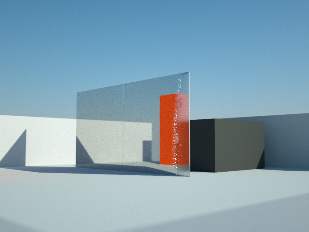

Hi there, I've seen Proupin's Frosted Glass (help me mate!), and as hard as I've tried I haven't been abled to replicate it with an specular material and I've had to use a glossy + opacity. So I would like to know if any of you have done a frosted like glass or even better a laminated glass with a PVB film http://www.cricursa.com/segur/prinprodu ... erTip1=207. My approach with laminated has been creating a realistic model, 2 solid 6mm glass meshes with a "plane" inside with the PVB with an opacity mask. I'm afraid the results have been quite bad, adding lots of fireflyes and unexpected black areas.
I don't seem able to make "white" glass, if I use white for reflection and transmission I get a clear glass, If I lower the transmission to grey or thru a floattexture the glass goes darker. I'm a little thick atm, so bear with me.

Yours looks good too, if you don't mind sharing your setup I would be thankful, but I would like more a PVB film without the noise and almost white but with some transparency. I'm certain there is something I'm missing, but can't put my finger on it. Basically I would like to make a white or better mask controled white glass.

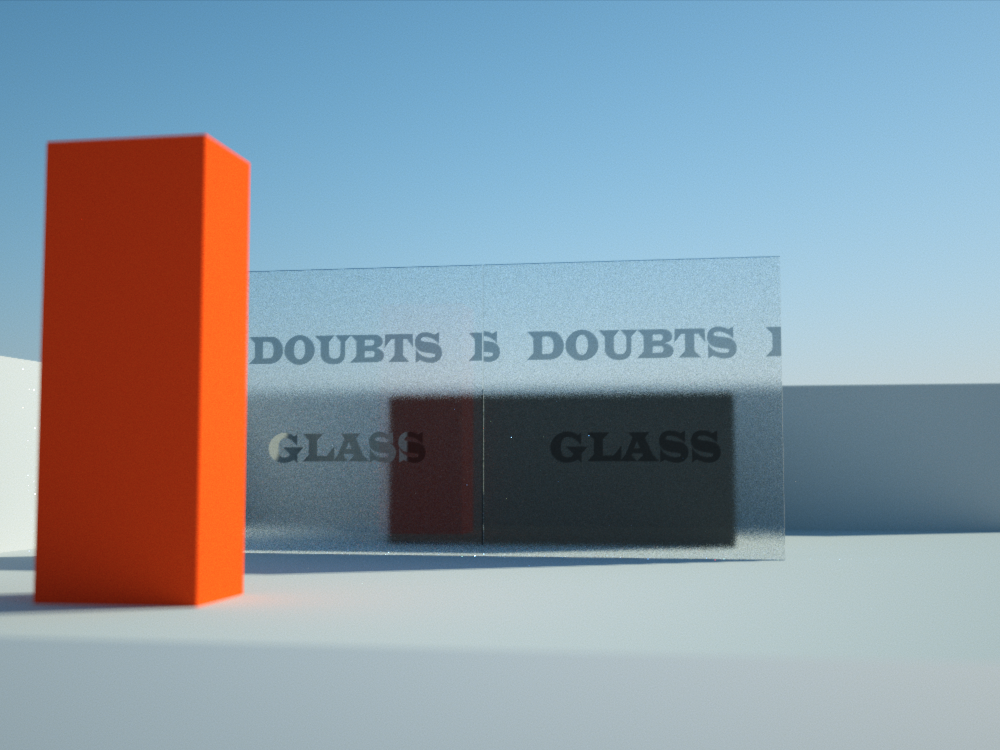

Here a test

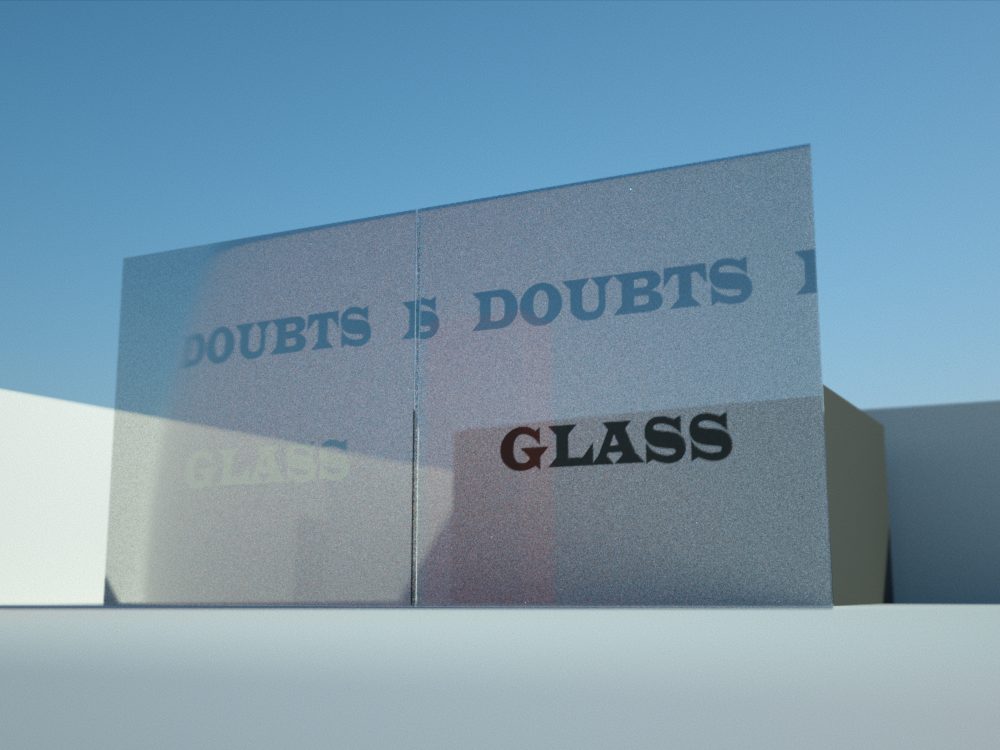

Thanks a lot mate, not only for the time to anwser but also taking the time to make a test scene.

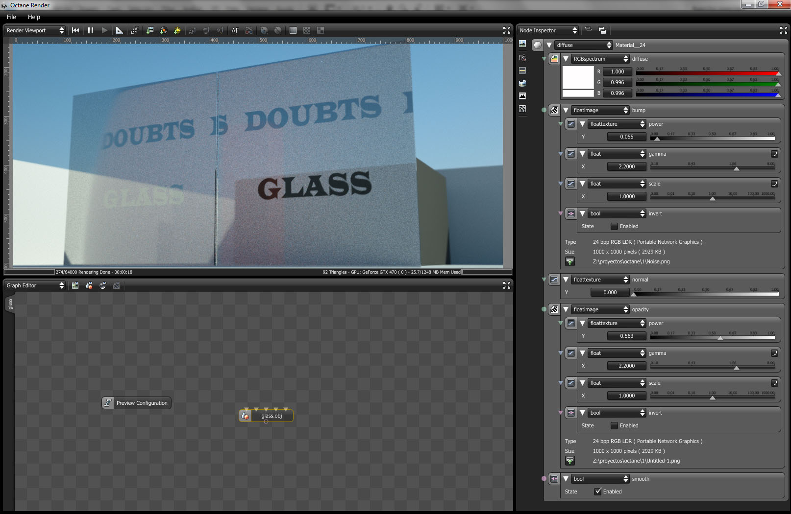

That's what I was looking for, the one you've made is a frosted glass (I'll keep it in my head for future reference), I needed one with a noisless film so using yours as a base I've changed the film material from specular to diffuse and that was just it, perfect, thanks a lot, you've solved my problem.
Also at first I was getting lots of fireflies, the bump map was set to 1 which can produce fireflies like there is no tomorrow, I've lowered to 0.1 or so, it still looks good but the images are free from those dammed fireflies.

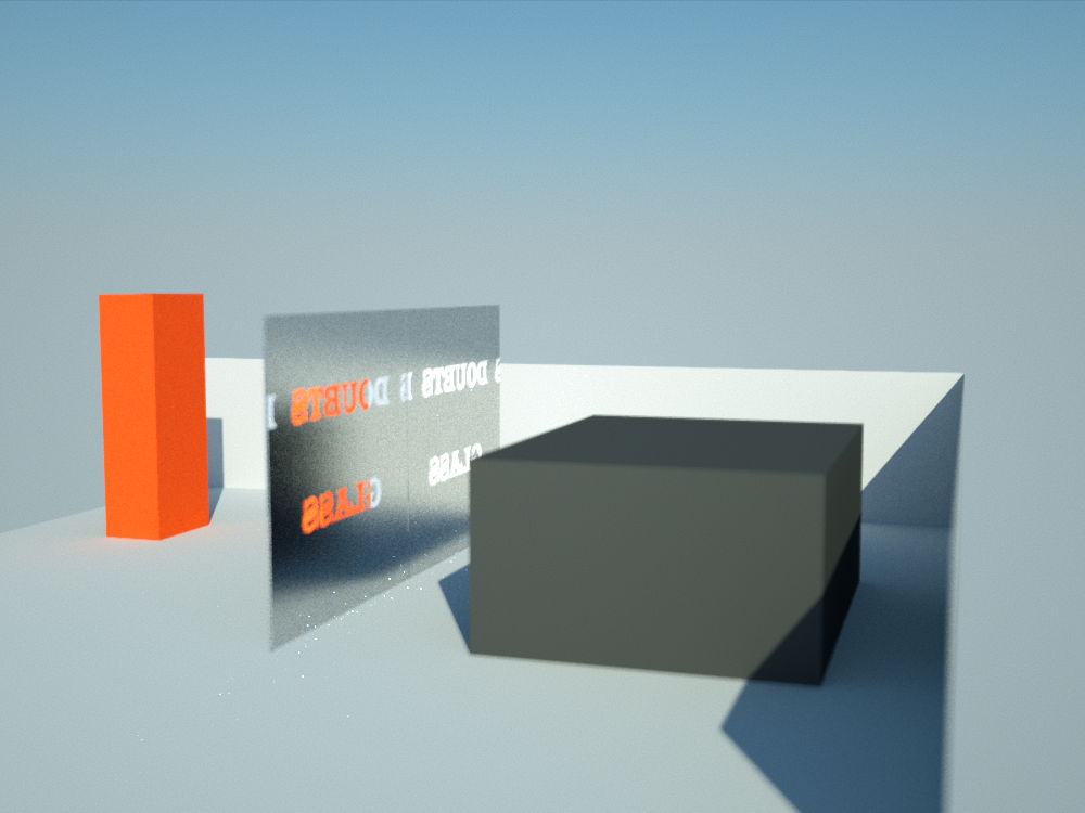

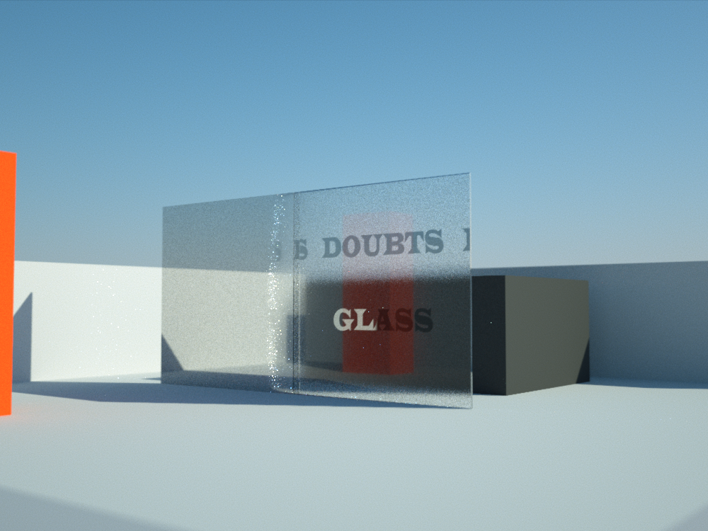

Now the funny thing I can't figure out is why depending on the angle is totally specular and doesn't behave correctly you can see the different angles in the images, also on the back side no matter the angle everything looks good.
I've included the variant of the last image back in the pack.
