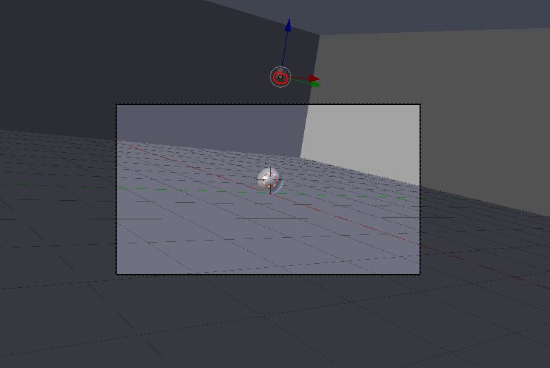

The OctaneRender and LuxRender output of the same scene. Why are they looking so different? In Lux the light source is at medium power, in Octane it has the highest value (100000.0000). I know the lightsource is very small (0.01x0.01x0.01 Blender Units) but i thought OctaneRener could compare to the big CPU-Based unbiased Raytracer.
The red is the light source in the tube.
