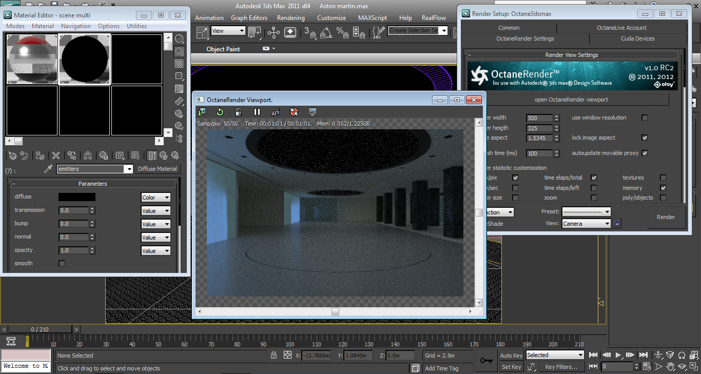

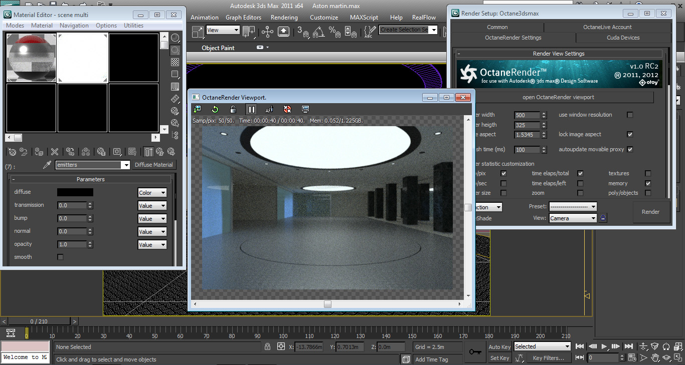

There is bug with Octane3dsmax RC2 concerning emitters. Posted these screens to show a single diffuse material with emission and how it's rendered with Pathtracing and PMC kernels.
Pathtracing with 0 diffuse and emission
PMC with 0 diffuse and emission

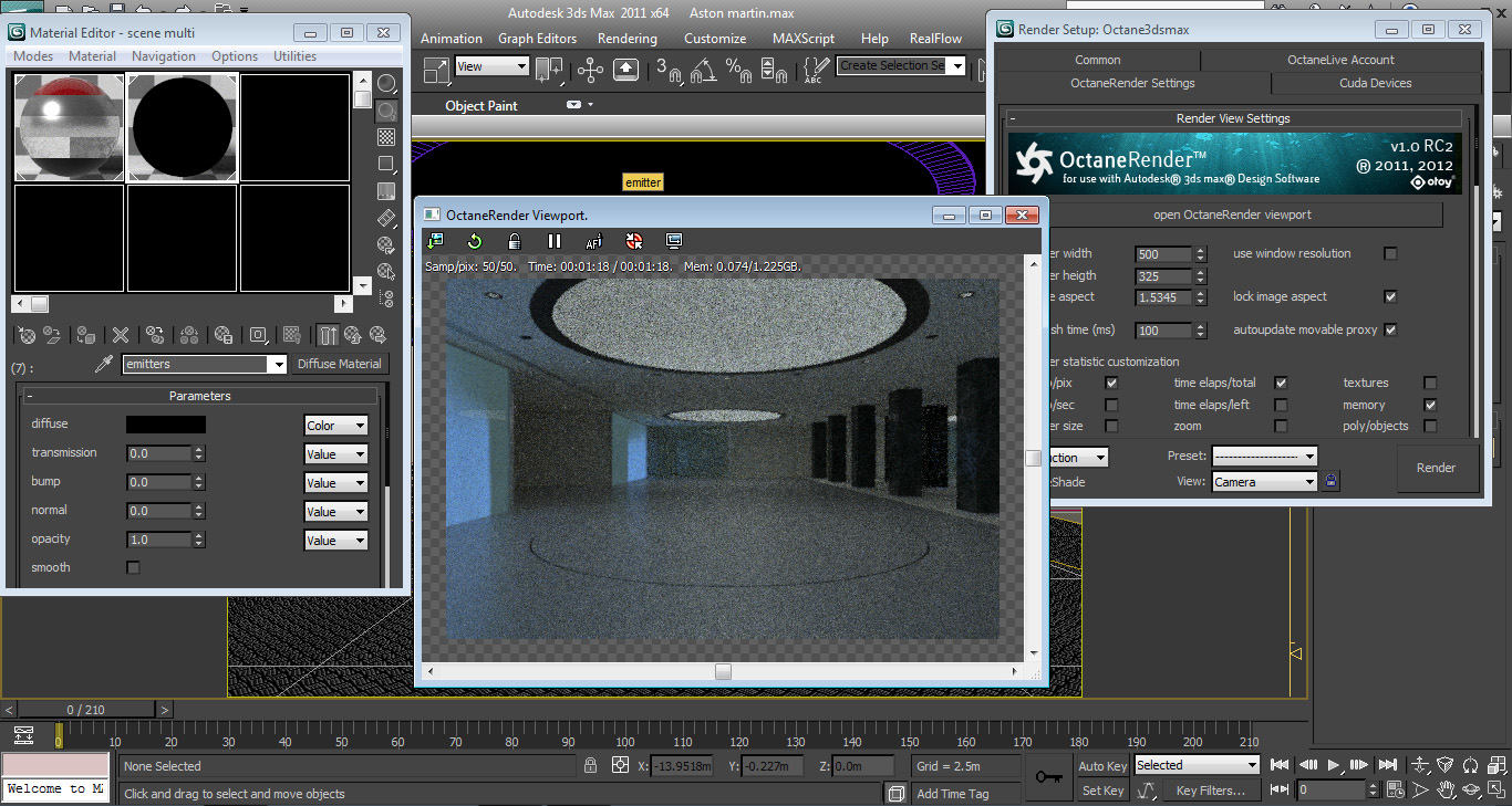

Pathtracing with non zero diffuse and emission

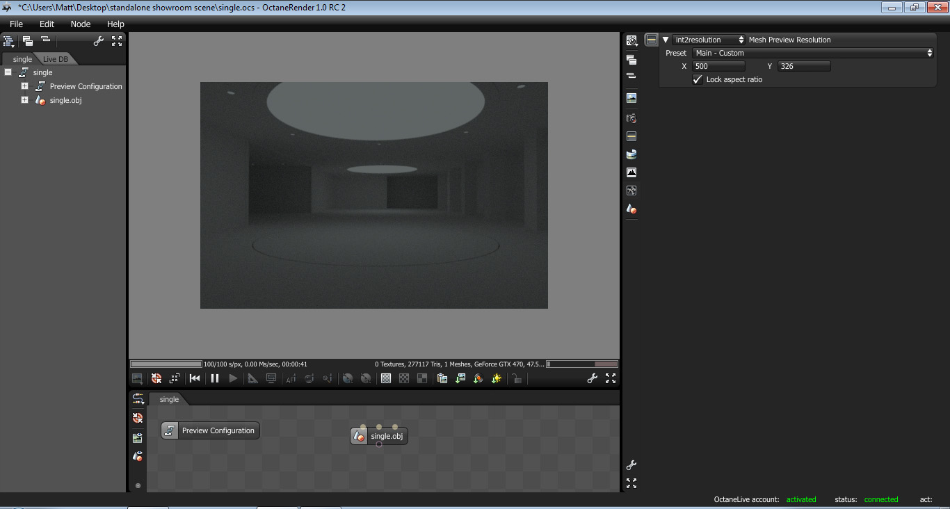

standalone takes 40 seconds
plugin takes 2 minutes 30 seconds
