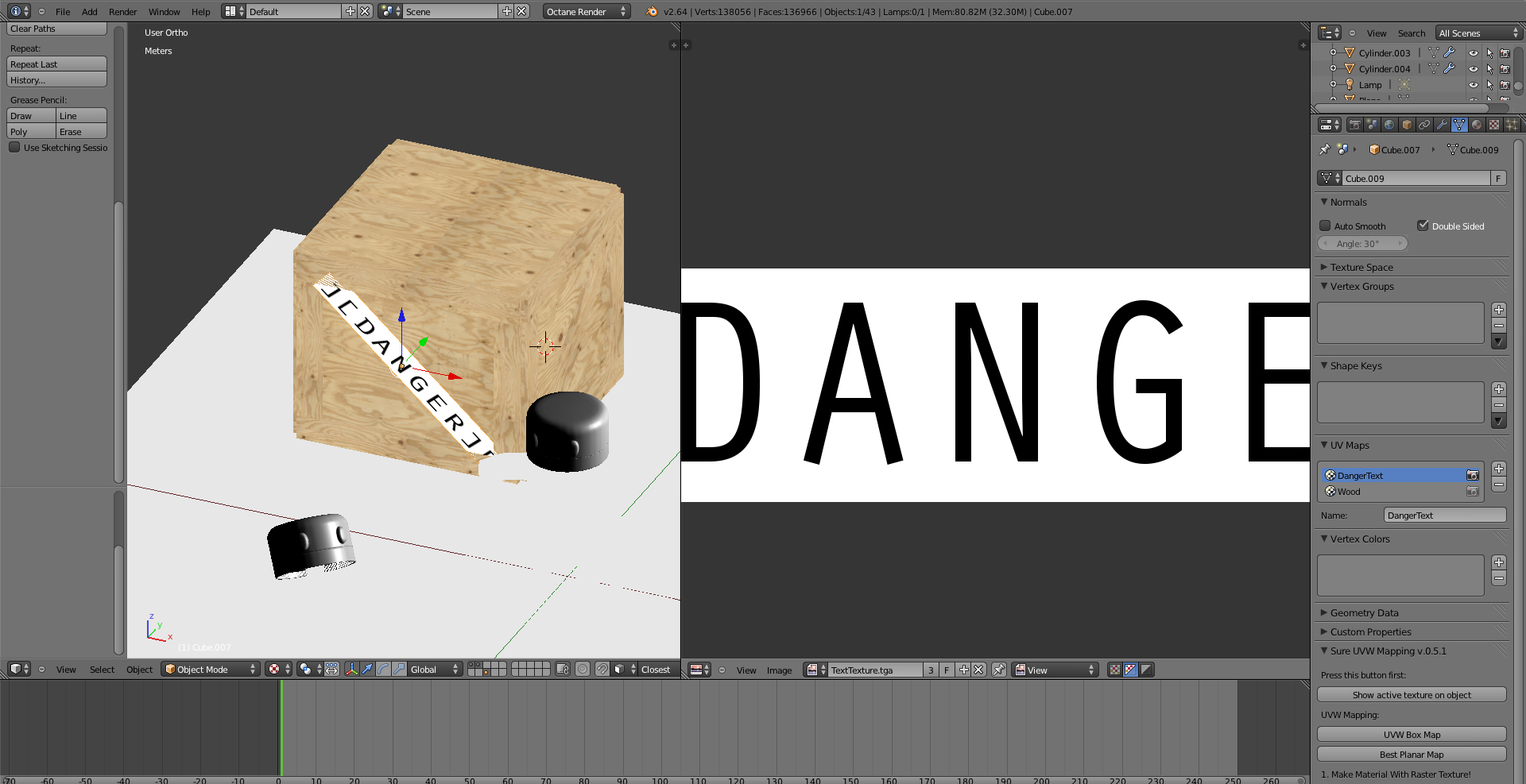

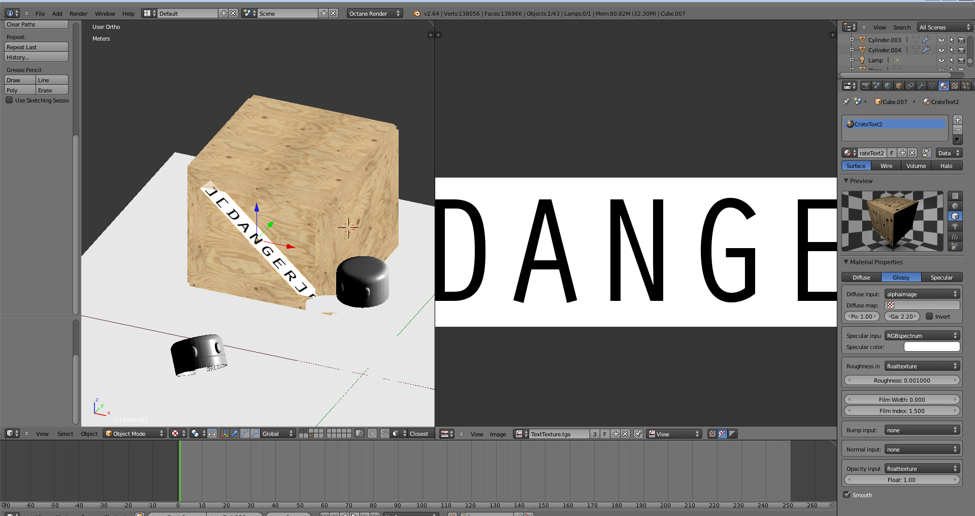

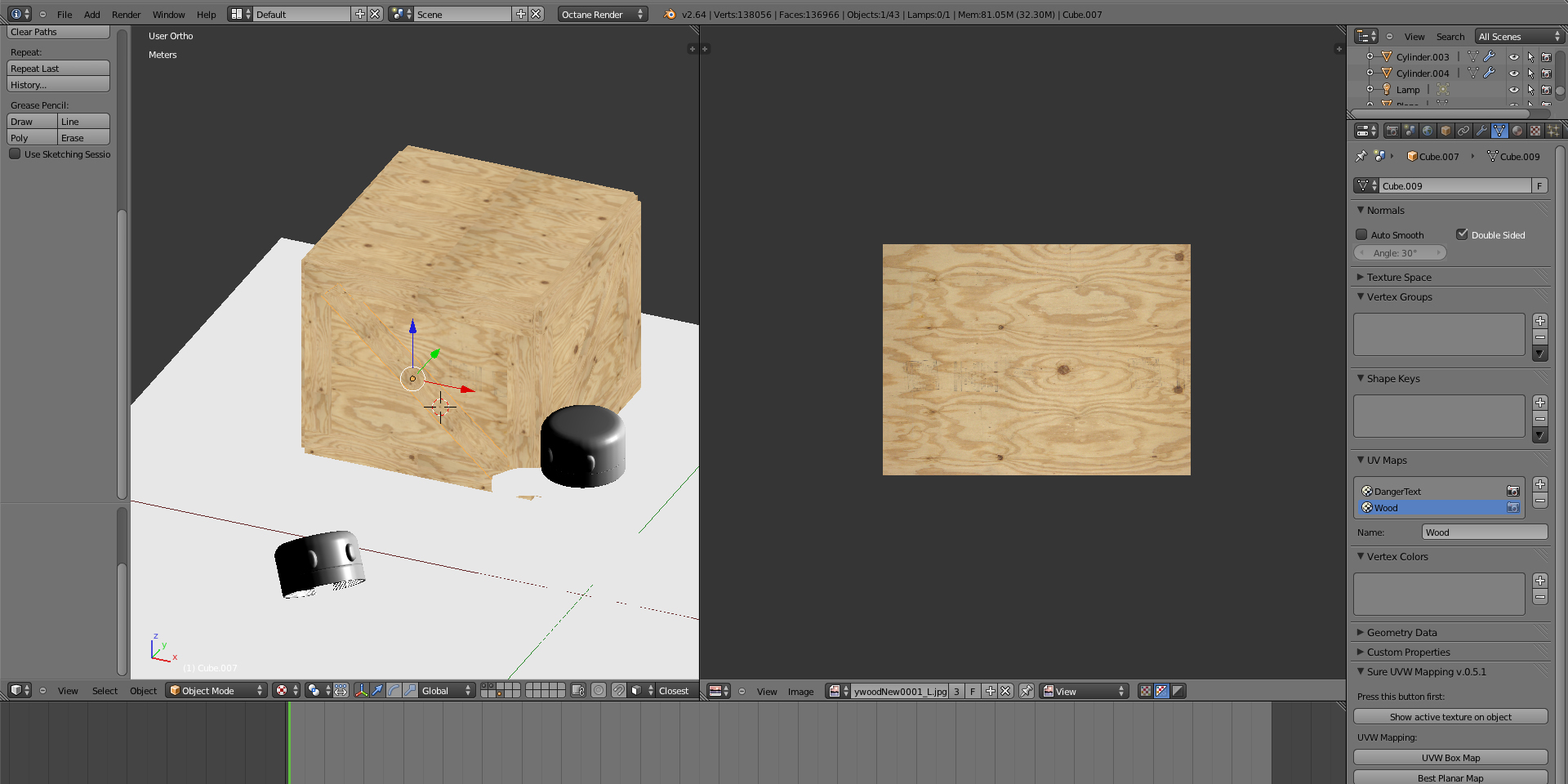

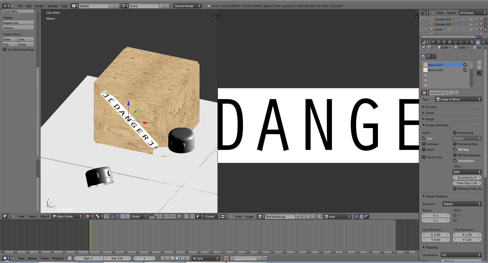

I'm really close into doing this, 2 separate UV maps made, my one UV is the whole object and the other is just a face to put the text on. I have 2 issues so far. One: I can only seem to get 1 texture to work at a time and my one texture that is just on the face repeats itself. I can't seem to make it stop repeating when I set the UV texture settings to just clip. I'm unsure how to get these working in Octane through blender.
Here are some screenshots- The UV maps are fine so I didn't bother taking those:

The problem is two uv-maps.
Octane only supports one uv-map because the obj-format can´t handle more than one map.
face
face

Oh, I see... So is there an easy way to allow text on top of my face? I don't want to have to make my own custom made texture just to add some bit of text on it. Not for this project anyways.
You can duplicate the box and move the faces out just slightly in front of the original box. Give it a different material and use the other texture with an alpha map.
Or, you can take your tileable texture and tile it in photoshop and merge the 2 images together. If you arnt worried about your VRAM getting eaten up it'll work but if your already short, this is a bad idea because that one image will be very large.
Intel quad core i5 @ 4.0 ghz | 8 gigs of Ram | Geforce GTX 470 - 1.25 gigs of Ram
Octane also doesn't have any control over UV mapping, except scale. So you'll have to exactly map your both textures on one single UV map.
I encounter this problem of yours a lot. That's why I'm always repeating we need per texture UVs and the ability to per texture transform the UV space of objects...

So Octane has to tile? I can't use clipping at all? - *cries*
