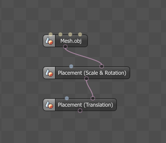

I was working with scale, rotation and translation with a placement node and discovered that with a single node, scale and translation are coupled together. What this means is that if scale is set to 1, 1, 1, and translation is set to, say, 0, 1, 0, then, if you change scale to say 20, 20, 20, then even though translation is still set to 0, 1, 0, it will actually move the object to 0, 20, 0. In other words, translation gets multiplied by the corresponding scale values.
If this is a bug, then that is a simple fix. If it is seen as a feature, then in order to uncouple scale and translation so that you can adjust translation independently of scale, just connect 2 placement nodes together like in the following image:
Placement Nodes.jpg (43.72 KiB) Viewed 801 times
Now you can do scale, rotation and translation completely independent of each other. Also, it allows the rotation centerpoint to stay where it was on import. If that was the center of the object, then using the two nodes as shown allows you to move the object and still keep the center of rotation at the object's center, no matter where you move the object.
