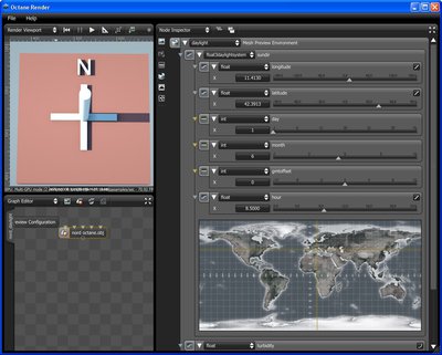

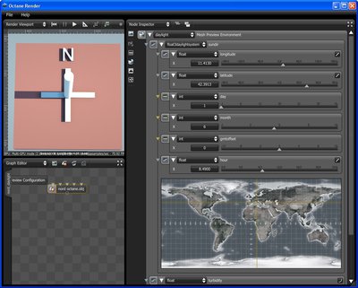

it's just me or when you set around sunset and sunrise time the light jumps in the opposite direction?
I'd like to post a demo obj I have made for this but seems I cannot upload obj or ocs..
so here are the images I have made to show the problem.
This currently means the impossibility to make sun studies for me.
as you see the first two images and the last two are made with few minutes of difference. the third is just mid day for reference...

this is a known issue to be repaired in beta 2.3, it's been reported quite a few times ;)

radiance you rulez, even if I post in the wrong forum!! it was intended for general discussion...
well, another reason to wait for next release.
thanks
