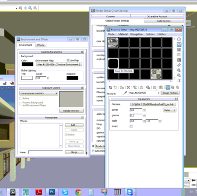

Hello, i have bean using the stand alone edition for almost 2 years but i'm new on the 3dmax edition.
i'm having some trouble placing an image for background, i'm trying to use the environment and effects window on the rendering menu by checking the "use map" on the background, but it dosent open a file browser in order to select an image.
Can you give me your advice,THANKS.

you need to place a octane texture environment node into the environment slot and then drag/instance to material editor. Then from the material you change the texture parameter from value to image to browse for a hdri/image map.

hello MaTtY631990, how do you change its orientation, rotation ? thanks

you will find the rotation parameter is on the environment material.

MaTtY631990 wrote:you will find the rotation parameter is on the environment material.
Not working. Sky is clear.
HDRI is not available!
Help!
suvakas
Posts: 503
Joined: Sun Jun 12, 2011 10:26 am
Sky? From where do you get sky if your HDRi is not working?
Do you have Octane sun in your scene? You can't have both at the same time.
Suv
swatt7
Posts: 6
Joined: Tue Oct 30, 2012 2:42 pm
suvakas wrote:Sky? From where do you get sky if your HDRi is not working?
Suv
M.. yes i have a sun... HDRY is not workin whitsh sun yet.... =( Waiting.... next release...
