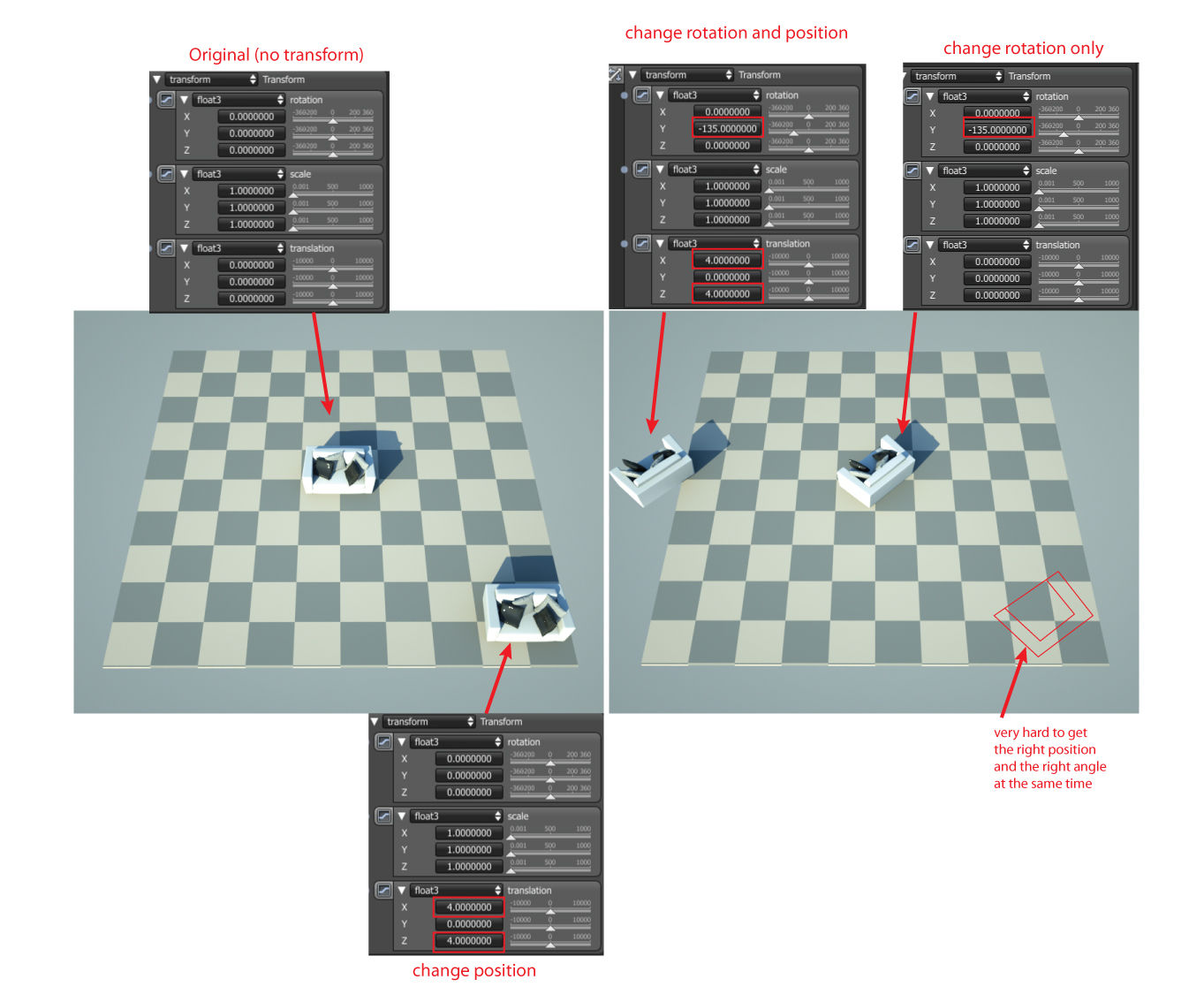

I think the instancing feature is something good for manage scene and re-use an object in future project... but....
I just give it up about re-use an object because of this problem that I show you in the picture... below...
Placement node problem

hi, the solution is to use two placement node, the first for rotation only and the second for translation ;)

Oh thanks for a solution....
but why.. we need to do extra job for this simple task... ? i wonder.....

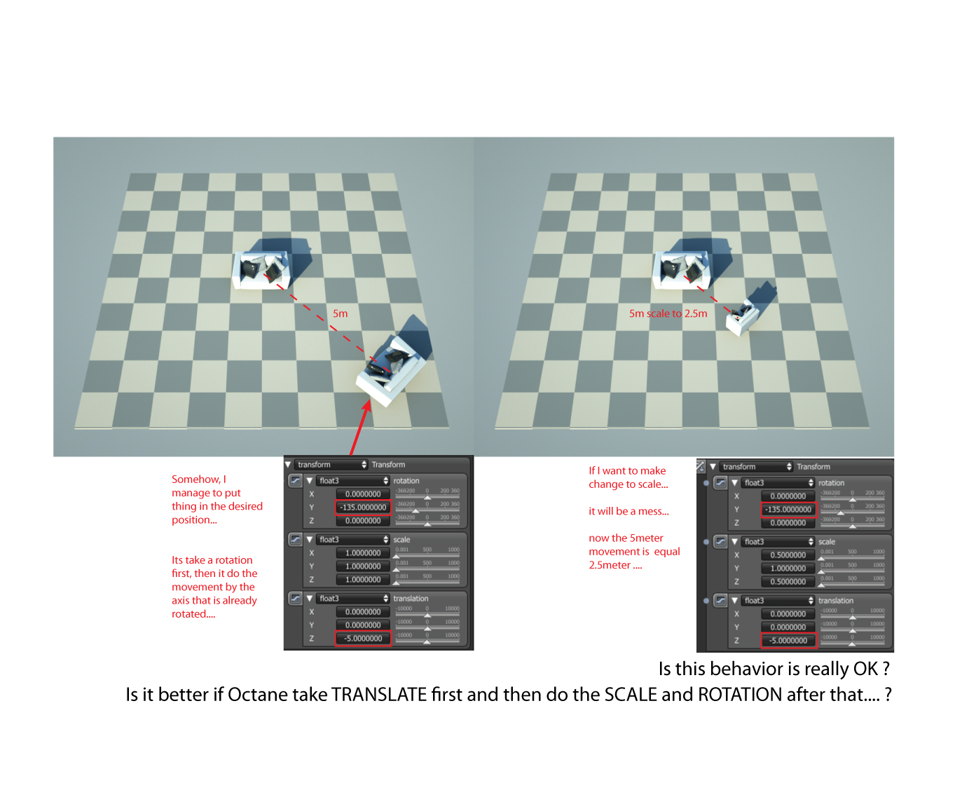

Imagine you have 20 pieces of thing in one scene...
If you want to put them all like this way (ready to move, ready to rotate) you need to put 40 placement nodes ... :ugeek:

@A2Zen: I totally agree with you ! I was going to post a feature request about that, in order to make this node operate Rotation treatment first.
It sounds much more logical imho.
Before thinking of using an other placement node first just for rotation, I pulled my few remaining hair to place my cars and city props in my current London scene !

the placement node is intended to be used with only few copies of an object, for more than three objects it's better to use the scatter node, if your host application can give you the matrix ;)

Roubal, I think the problem now is "this node operate Rotation treatment first"... ;)
Maybe we understand thing in different way ? :roll:

It´s simple,
you must convert your desired rotation in a 3x3 rotation matrix. Then multiply your destination vector with this matrix.
Subtract your result from the destination vector. This is the vector which you must type in your translation value ;)
