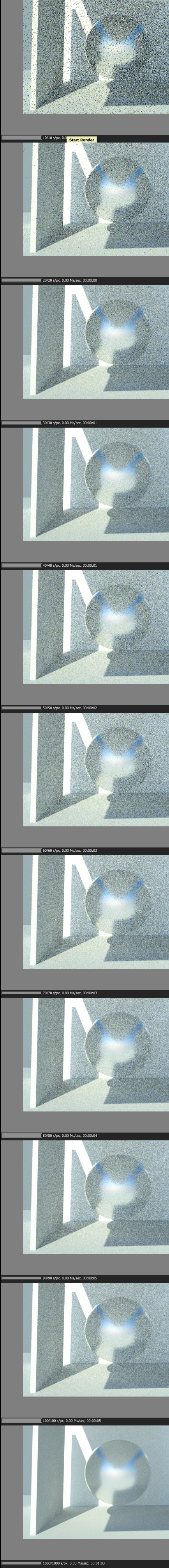

Hello Fooze,
I am not comparing to any other version of Octane, but I noticed a difference.
I attached a strip of images with different sampling numbers in PMC using the default settings.
The noise suddenly increases around the 60th s/px, I've compared the image at 30s/px with the 80 s/px and the later has more noise although is slightly brighter.
I am guessing, this is because only later in the process the PMC algorithm starts doing "exploration"?
Maybe not as the same thing happens with a scene with diffuse only materials.
I also attached a sample scene, just press render and see it happen.

An increase in brightness is normal, PMC is often too dark with a low amount of samples per pixel. After the rendering reaches around 15 samples per pixel you may see some low frequency noise popping up, this is due to how the exploration works. In your images I don't really see an increase in noise from the low s/px to high s/px images.
PMC has an advantage over path tracing mainly in scenes with complicated lighting, like scenes with lots of light sources or scenes with lots of caustics. In diffuse only scenes path tracing may work better.
