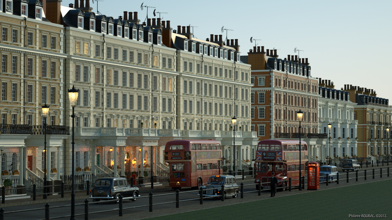

Will we get any improvement in term of allowed number of texture ? Currently, I reach the max on my big London city scene...
I would like to animate the scene, or at least the camera, and so I couldn't delete the textures each time the camera moves. All object and characters are detailed (vegetation will also come).
Below, a low sample recent screen shot during rendering.
The node graph is very crowded, and it becomes more and more diffficult to place the instances. I am constantly panning.
If you use only Kepler GPUs, then yes with the upcoming release you would get more textures (144 LDR RGBA, 68 LDR greyscale, 10 HDR RGBA, 10 HDR greyscale), otherwise not. The reason is that Keplers allow more texture references. We hope to solve this problem in the future for Fermi and Kepler cards, but we are not there yet.ROUBAL wrote:Will we get any improvement in term of allowed number of texture ? Currently, I reach the max on my big London city scene...
The next version will also deal differently with too high texture counts. You will not get a pop-up anymore, but the colouring in the render status will indicate that you are trying to use too many textures. All textures that don't fit into the texture limit, will be rendered black.
Regarding the node graph editor: Yes that's one of the many items on our to-do list.
