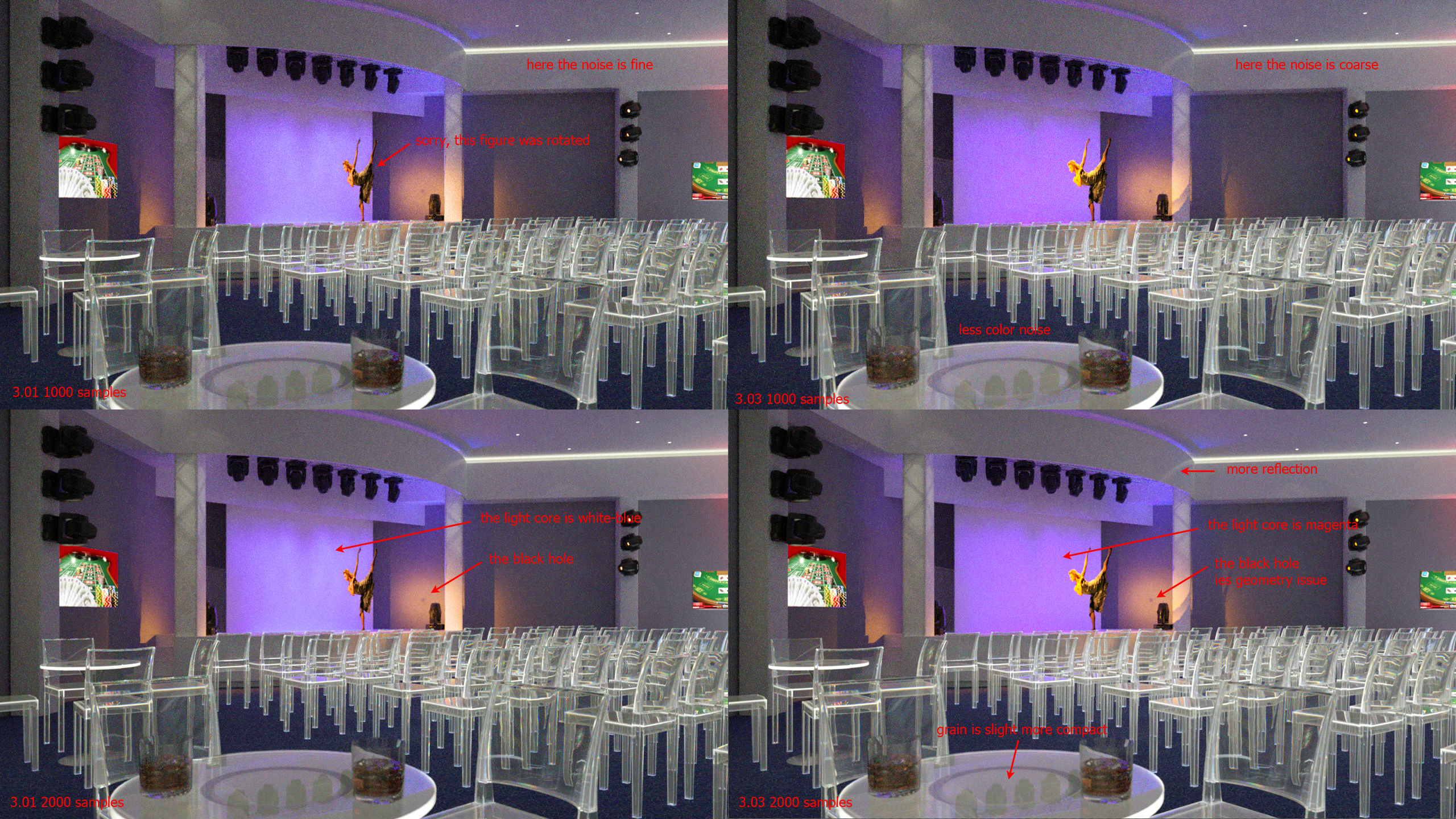

Here a comparison between 301 and 303
I think it's ok at the moment.
Speed is slight slower, for example 1.670Mpx/s for the 3.01 and 1.620Mpx/s for the 3.03
Regarding the light core yesterday I was asking to myself why the colored light tends to white if the power is high.
On blue lights now the light core is magenta.
But how to create a totally blue projection? I mean, how to simulate a totally blue light with gels without color shift?
The ies light suffer of an old issue that I reported 5 months ago, you see projected the shadow of the emitter. In fact I never use ies emitters but circles, but now I have to use them.
The grain is slight more compact, probably you changed the sampling method, or increasing the reflection we have less bounces then less noise.
Thank you for your hard work.

gabrielefx wrote:Here a comparison between 301 and 303
edit: camera clipping is the best Octane's feature.
Hi Gabriel,
regarding the light core colours: Could you try using the saturate to white slider on the imager settings? Another option would be to desaturate the colour of the light gels.
