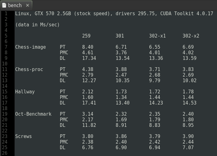

My results (.txt attached)
* 259 is the fastest build
* 301 is the slowest build
* 302 x2 is the fastest among 3xx builds
* From 301 to 302 PMC gains more speedup than other modes
* Screws scene is the only scene where 3xx builds are all faster than 259 (considering margin of error there in PT)

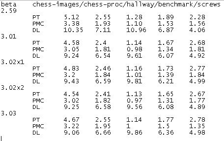

here you go...one apparent anomaly in 3.03 PMC screws -double checked it though.
my processor is running at 3.16 ghz atm and the 460 is o/c 12.5% core and 6.25% mem.
HTH
edit: updated to include 2.59 - a bit of performance loss since then at least using the same cuda5 driver (although not as much as I was expecting) but the screws scene is better now :) except for PMC :cry:

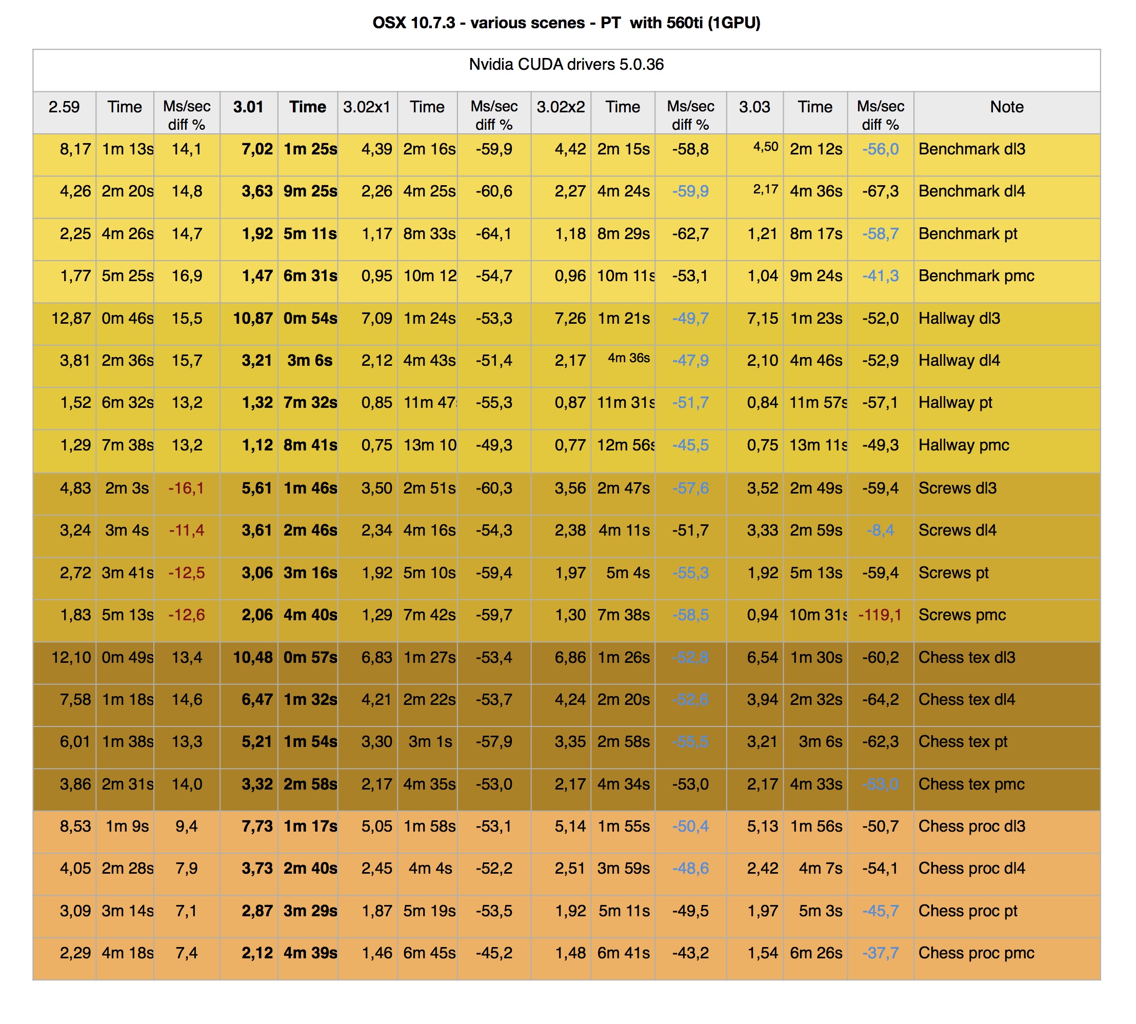

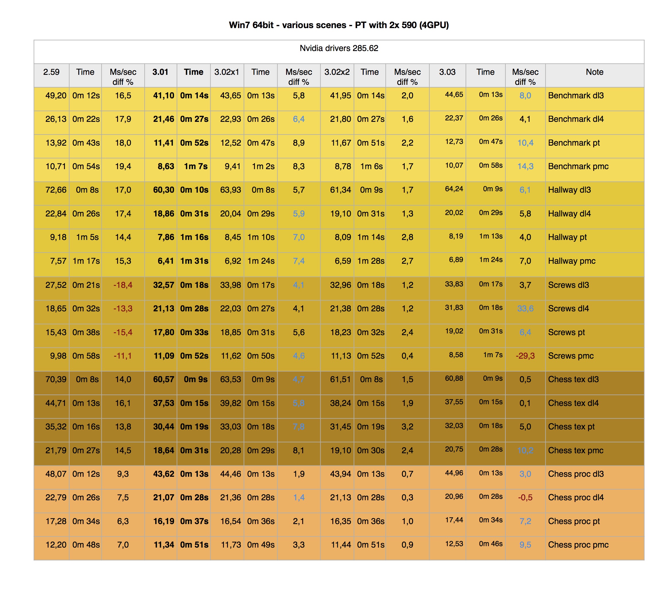

here is my table, unfortunately the mac versions are always slow with some little difference.
the screws scene is crazy in every system :D
i hope that you could find some useful information in it :roll:
light blue for the best score
dark red for strange result
pdf and xls version in the zip file (is made with ipad so i don't know if the xls version is usable)

The reason why the screws scene is so different on 3.02/3.03, is because the glossy materials behave very different in 3.02/3.03.

What happened to PMC between 3.02 and 3.03? It went from 1.8ish to 1.35 for me - 25%...

pixelrush wrote:What happened to PMC between 3.02 and 3.03? It went from 1.8ish to 1.35 for me - 25%...
Are you comparing 3.02x (using the old BRDF) with 3.03 (using the new BRDF)? Nothing changed in PMC, but the BRDF changed.

Thanks for the feedback. I think there is something fishy going on on Mac OS. Is the 560Ti officially supported on Mac OS? Which CUDA driver does support it at all? I think the CUDA driver is the problem here, but that's just a wild guess.
