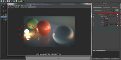

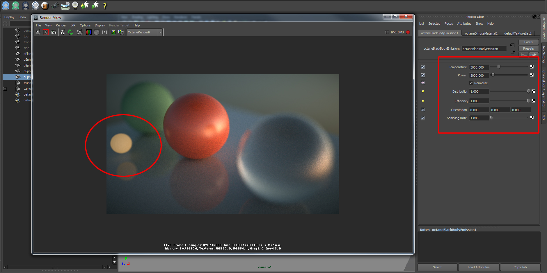

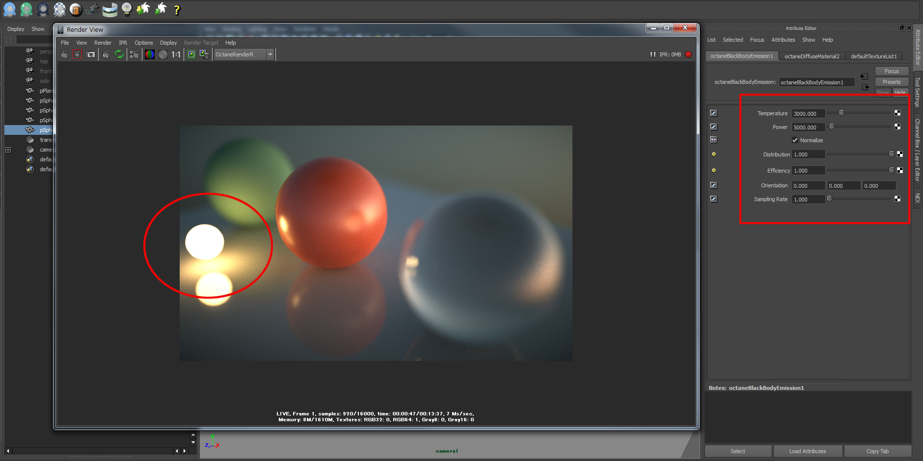

I've set up a simple test scene, one of the material is diffuse/emissive (see sample2.jpg).
When I re-open the scene and hit render, the intensity of the emissive material is very low (see sample1.jpg)
As soon as I touch any of the emissive parameters, the material goes back to it's original intensity. It looks like a refresh settings problem. ;)
