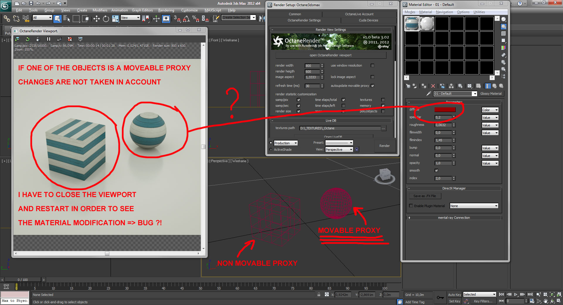

Hi Karba
I don't if it's a bug, but I think it's a bit strange behaviour.
When I tweak a material, for example, I change the diffuse slot from color to texture.
If the object is not a proxy => the modification is take in account immediately and is visible inside the ViewPort. :D
If the object is set as Movable proxy => nothing happens. I have to close the OctaneRender Viewport and restart to see the change.
Can you check this ?

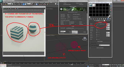

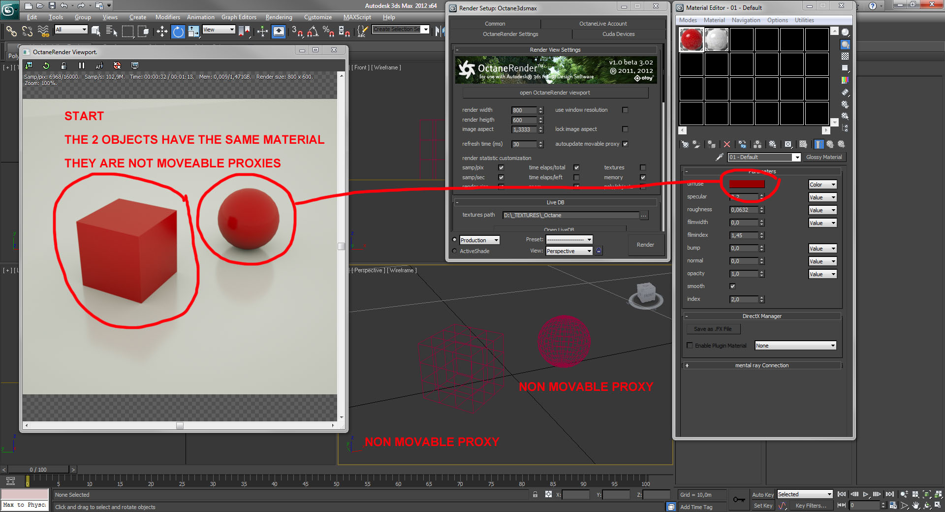

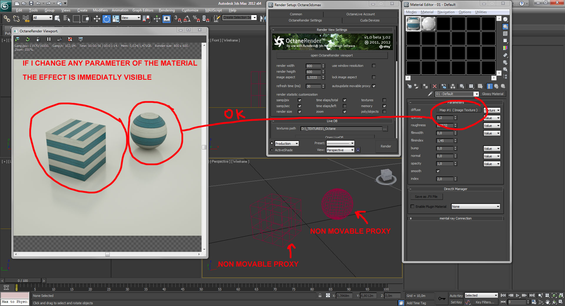

Hi Karba
Here some images to illustrate my problem. Easily reprodutible.
Config : 3dsmax 2012 64 / 2 GTX590 / driver 306.23
Hope my explain is clear enough
PortFolio
4 x TITAN - Win 7 64 - Octane Rocks
Karba
Posts: 2300
bicket wrote:Hi Karba
Looks like a bug. Will check it next week.
