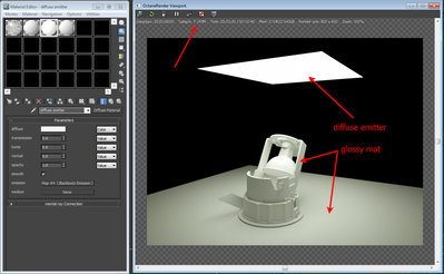

Hi all,

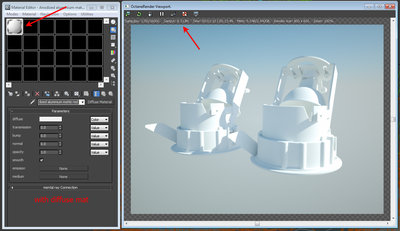

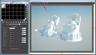

Someone probably already know that with the new glossy node we can create "diffuse" materials setting the specular to 0, roughness 1, index 1.6 (very similar to the Vray default settings)
The curios thing is that the new fake diffuse-glossy mat produce faster renders.

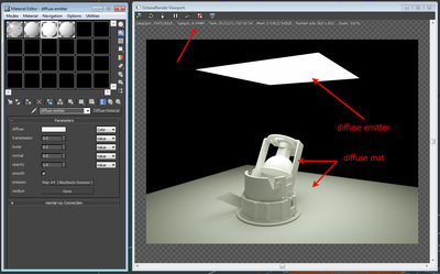

Also I tried to delete all the diffuse materials from my test scene, for light meshes too.

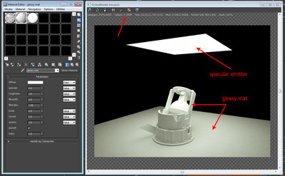

Using a specular mat with a scattering medium we can simulate a diffuse emitter.
Unfortunately the specular emitter produces noisy render.
I suggest to limit the use of diffuse material.
Regards

as far i see from the images, there is a floattexture node connected to the transmission pin of the diffuse mat. even if set to zero, this already slows down performance, compared to the same diffuse mat with an empty pin there...

t_3 wrote:as far i see from the images, there is a floattexture node connected to the transmission pin of the diffuse mat. even if set to zero, this already slows down performance, compared to the same diffuse mat with an empty pin there...
the diffuse emitter is for the light only, the floor and the lamp have a diffuse material without any emitter in that example.

are you sure? In 3ds Max the diffuse material is a single node.
The transmission is 0 but there is no second node attached to it...
I'm missing something?

hm; i don't know how the max/maya plugs handle this, but i tested it again in the standlone: some object, rendering at ~16.8ms/sec (pmc) with a single diffuse mat and with no node attached to the transmission pin (=default). then created a floattexture set to zero, connected it to the transmission pin and speed went down to ~16ms/s - not that much difference you encountered between "fake" diffuse and diffuse, but still a some ~5% ...

The speedup when using the fake emitter occurs because Octane is not tracing any shadow rays anymore. This means less work per sample and thus more megasamples per second, but this will usually lead to more noise after the same time.
