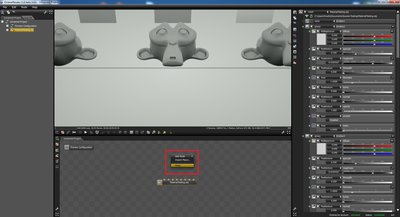

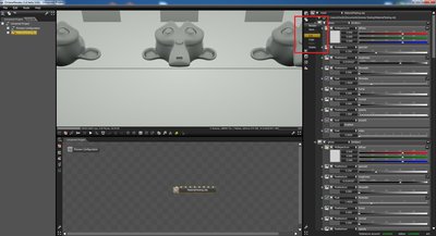

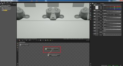

In the latest beta 3.01 (and for a few versions before that) you can right click on a material node - cut and paste to the node graph.
ie:
But this is not in the demo sorry.
