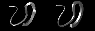

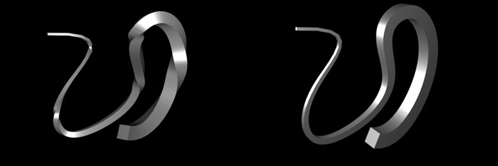

Yes, strands are special.
They are only curves which are send to mental ray with the shape they should have.
That was the problem which i had to solve. But the conclusion is, my strand meshes are better than the rendered MR ones
face
