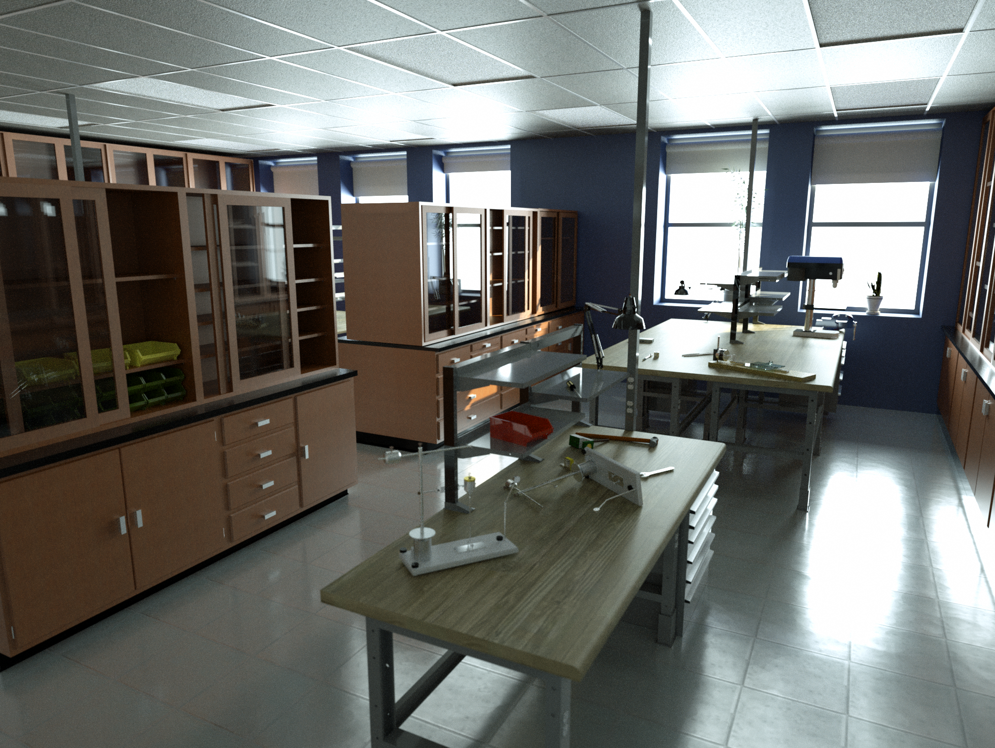

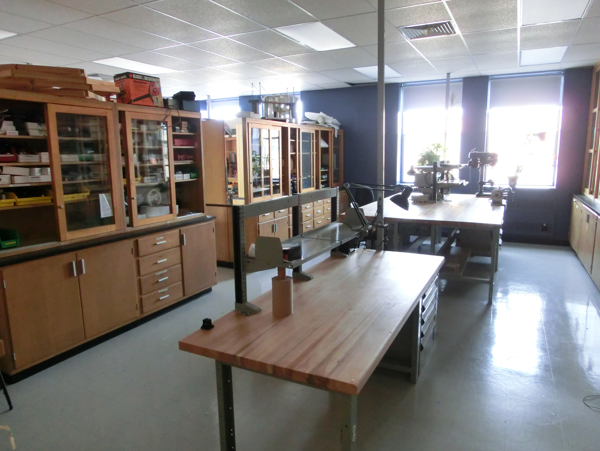

for fun, I tried to replicate the more realistically possible my workshop. It took me allot of test to adjust the textures parameters.
You can compare with the reference picture.
I could do better, but it is very long between each render.
It could be nice if you have any advice to increase the realism. I would love to have in the texture parameters some tabs like : finger prints, dirt, dust, scratches... :P
The geometry is made in Sketchup. The light come from a large black-body emitter outside with no glass in the windows.
You can download the project here https://www.dropbox.com/sh/p9xwfw6luvkwqam/HBOm4co48C
Render time : 8h
850 000 triangles
GeForce GTX 560
If you have any advice to accelerate the render time with the same realism. Thank you for your comments.

This is great! Looks like a photo!

This looks very great! Well done !!
These are my 2 cents if you wanna improve something, I guess.
Sunlight, Use 2 lights if possible or make your light slightly bluer; check the floor, it has sky reflection on it.
If you want, use Photoshop, Color Range the brightest part on the image & add some Diffuse Glow & color it to a slight blue for the windows
The bottom of the image lacks brightness & saturation, try to make it more vivid with the materials, check the foreground table reflection.
The ceiling should not be that reflective, use more roughness & reduce specular.
And maybe try to change FOV or the perspective using Photoshop, it's definitely visible on the foreground at the bottom that it's different from the pic.
Great render :D

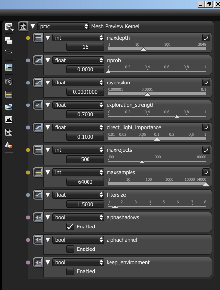

to increase the speed 16000-24000 samples are enough
I never use 16 bounces in PMC except I got several glass walls, I use 8-10-12
one single GTX is not enough for the rendering job...you need a minimum of 2 gpus.

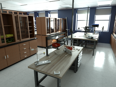

I tried at maxdepth 8. After 8h the noise level is the same, but the glasses are darker.

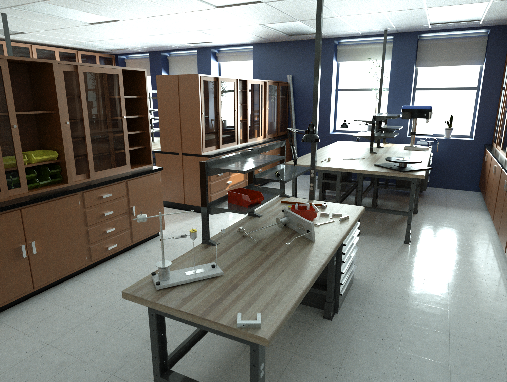

(Full resolution https://www.dropbox.com/s/g3kfqb9n56pkj ... le%208.png )
I really like my floor :P I added some dust on the floor, turbulence and image bump, and specular image for the lines.
It could be nice eventually to use the instancing to put real geometry dust everywhere.
virtually everyone to whom I showed this picture to thought it was a photo :D
I could do better, but it take too much render time before I can see the results.
I will eventually buy a second GPU.
Thank you for you helps.
Gabrielfx, I just putted one light source, because I found it less realistic with a back light. PS : I really like you renders :)

Great work and improvements.
The floor tiles have a nice material.
Time to put stuff in the shelves.
Posts: 10544
wow, if you catch the wood colour and reflectivity it's perfect :)
ah, and a little bit of dof also
